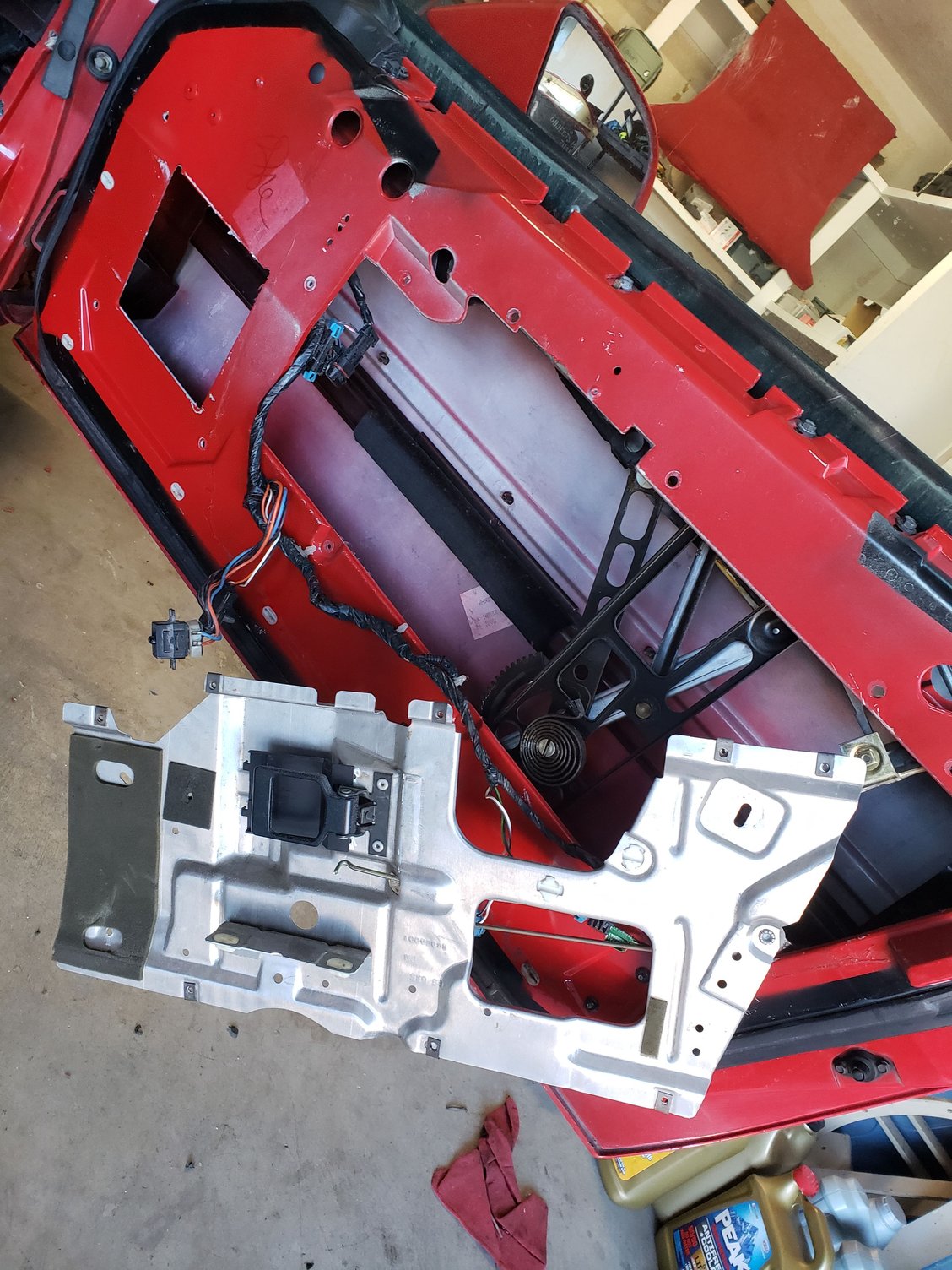

Does one need to "adjust" or "realign" the windows if one has completely loosened and removed the two bolts that hold the metal tray thing inside the door panel and removed that?
Picture related.
