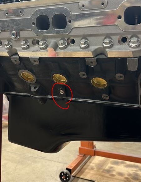

Hi
I recently placed an order for a new 383 SBC longblock and but later discovered it's not 100%compatible with my 1991 C4, hopefully these are solvable. One thing is the valve covers are perimeter bolt style so I'll have to find a new pair. Another issue is it doesn't seem to have a hole for the knock sensor from what I was able to see.
Any idea where to drill a hole and does it need to be all the way through to get in contact with the coolant it only needs to be very firmly attached to the engine somewhere in line with a cylinder? Also the oil pan it seems to be missing the oil level threaded hole, but I think the stock should fit.
This is how such block looks like:
Thank you

Every sbc has a drain hole on the passenger side, that is where gm put the knock sensor on the 85-91 c4, 84-85, and early 86 c4 used the same style valve cover, but they had perimeter bolts, find a set, they look the same and are functionally identical to the 87-91 valve covers.
The chrome looking plug, remove it and install the knock sensor.

What about that hole?
This might work:
https://www.summitracing.com/parts/icb-551542

Thank you, I’ve seen that chrome looking plug, but doesn’t seem to be exactly in the position of the l98 sensor, anyway I’ll ask the shop for detailes.

PS those marked by JoBy and Bill are 1/4”NPT, which is the same used by l98 blocks I understand, not sure if the positioning is identical but that wouldn’t be a problem in most cases.
