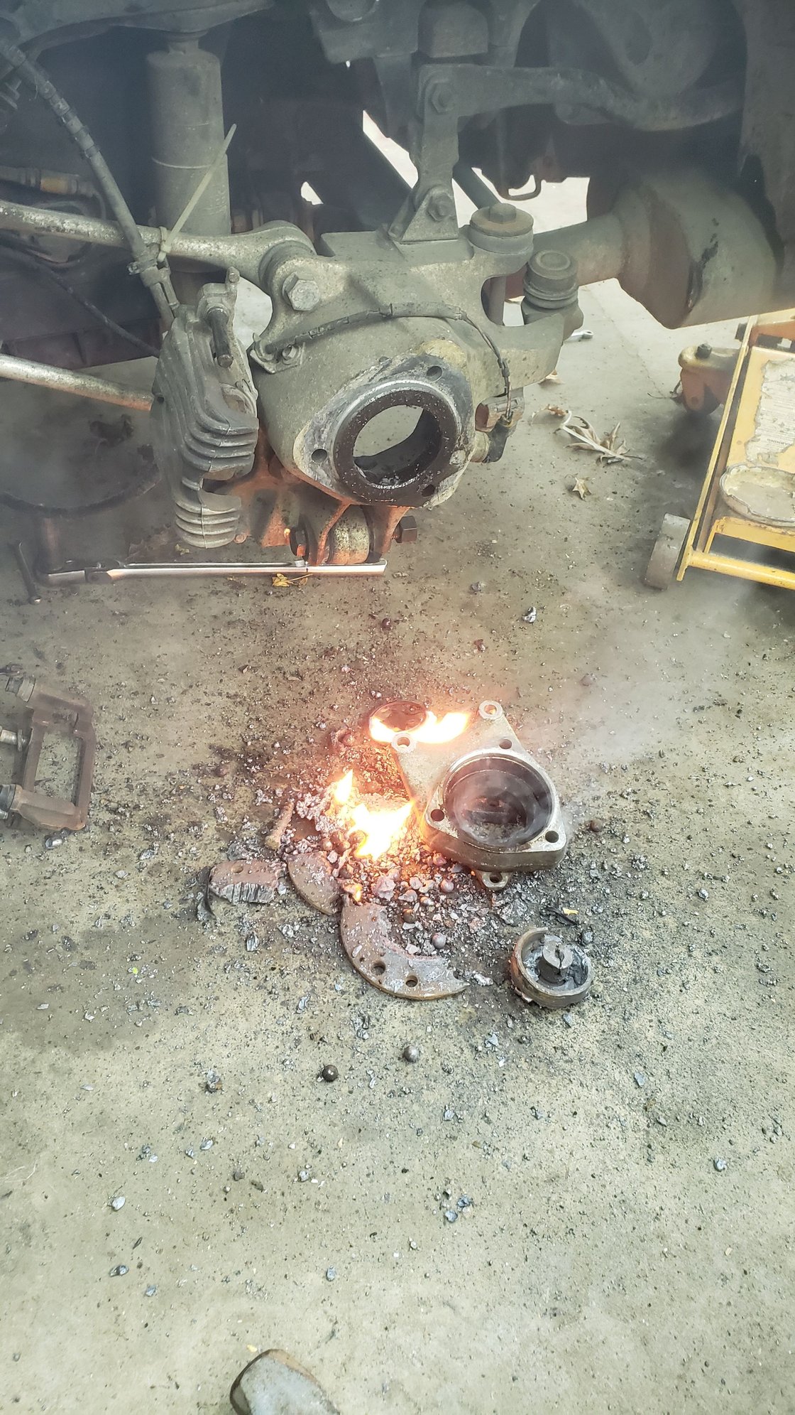

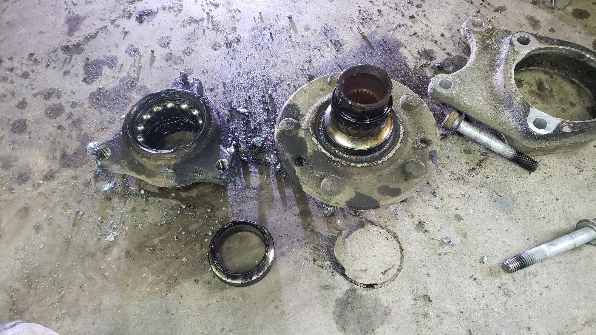

I had trouble getting my bearings out. I ended up replacing both splined stubs as well, since they were destroyed trying to remove the bearings. My opinion, take them out and put some anti sieze on.

Originally Posted by MatthewMiller
But also, the factory didn't put anything on them, and yet your friend was able to get the old ones out without a torch. If you/he doesn't mind pulling the halfshafts out again and putting some anti-seize on them (which will probably last a lot longer than plain grease), there's no reason not to. But I sure wouldn't panic over it or pay someone else to do it.
Thats a good point. I'd say it depends on how the car is used. If it's just a sunny day driver, it'll likely be ok. If it's a daily and sees rain, then it's probably a good idea to take precautions.
I don't know how mine was treated before, but I'm pretty sure it was driven in all kinds of weather and sat out in the rain.
