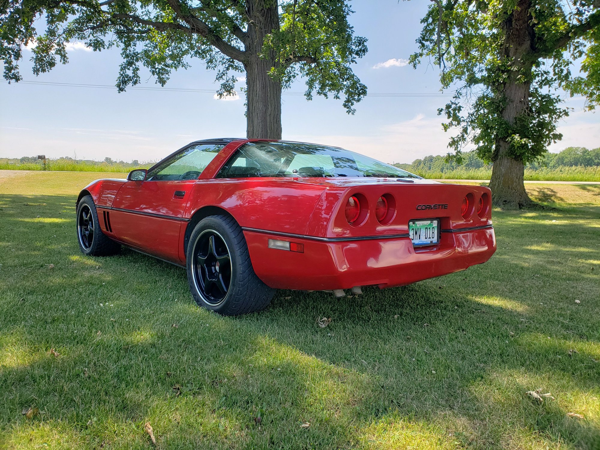

I mounted 96 "Grand Sport" wheels, black, on my 1984, read this thread: Grand Sport Wheels
1984 with 1996 Grand Sport wheels
