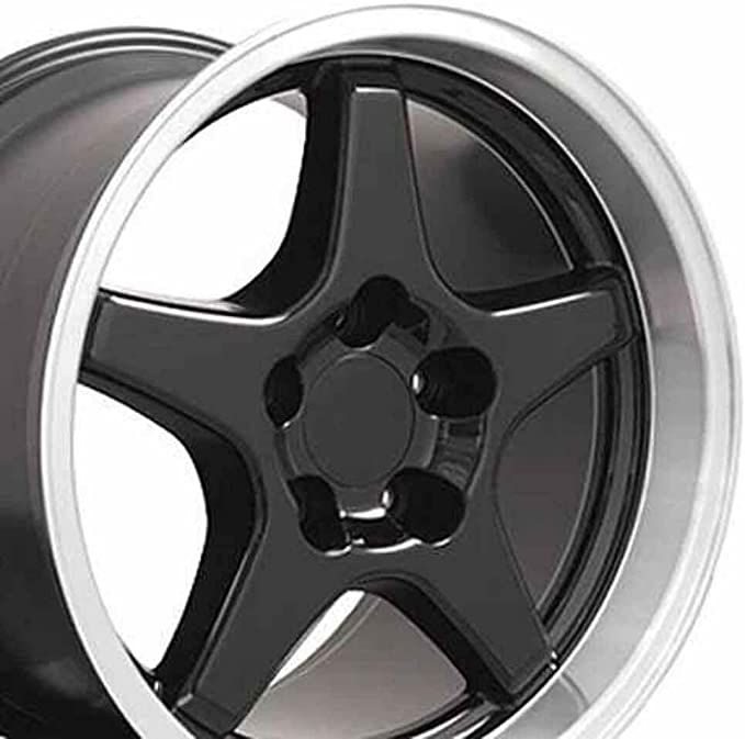

I'm sure this has been beat to death, but I've got an 84 with factory tires and wheels that has been sitting for a long time. It's getting imposible to find 16" tires for the car so I've decided to go with 17" or even 18" wheels. The car is light blue over dark blue and I think the ZR1 wheels in black will look the best but I cant find the wheels either due to the offset. Any ideas or do I buy spacers and order for 89 and up? If I go with spacers what size wheel and tire do I run? Thanks

You can use C5 wheels .You will need some spacers. They are staggered.
  • Front: 17 x 8.5 Tire size: P245/45ZR-17
  • Rear: 18 x 9.5 Tire size: P275/40ZR-18
  • Bolt pattern 5x4.75" (same as 5x120.65mm)
  • Front offset= +58mm, Back Spacing= 7.0" (177.8mm)
  • Rear offset= +65mm, Back Spacing= 7.5" (190.5mm)
Some people use one size all the way around .But you would need to buy 2 sets.

Any factory wheel designed to fit 88 and up cars will need .75 inch adapter to get back to the factory position on an 84-87 car. That being said,you know there is some wiggle room there. You like to keep them under the fenders so a 1/2" spacer with a factory 88 up wheel would work good. 1/2 spacers are easy to get and still safe with longer studs installed.

I've got sitting in my garage a brand new set of 17X9.5 with 56MM back spacking and 17X11 with 50MM ofset ordered by mistake. Would the 1/2 spacer make them work and if so will they stick out past the fenders. I dont mind the back just a little. I can send the wheels back if I need to.

The 11s will fit front and rear, but like someone else said, you may need a bit more than 1/2". To run those spacers (you can't get them that thin in adapters), you'll need to install longer wheel studs. 3/4" spacers or adapters should work well for you. Plain spacers are actually lighter, stronger (there's literally no way they can fail), and you don't have to worry about the studs in the hub hitting the backs of the wheels (you might have to cut them). I prefer them, but you have to factor in the cost and hassle of swapping out to longer studs. 315/35/17 tires are the ones to run on these wheel, and there aren't a lot to choose from, although there are two or three decent choices. All of this goes for front as well as rear.
For the 9.5" wheels with 56mm offset, stock 9.5s on your car (the Z51 wheels) had 38mm offset. So for that to match the stock placement you'd want 3/4" spacers or adapters (19mm), which would get you to 37mm net offset. Same goes for the rear if you end up running them square. Run these with 275/40/17 tires and you'll be in good shape.

Actual OEM C5 wheels are all staggered in diameter. IMO only, that doesn't look that good on a C4. The C5/6/7 needed that stagger to hide its disproportionately big butt. The C4 has no such problems and looks best with wheels of equal diameter. I get not wanting to spend the money for Forgestars. One idea is to look at OE Wheels. They make replicas of lots of different Corvette rims, include several C5 styles. I think they only come in later-C4 offsets (usually 56mm), so you'd still need spacers, but you're going to need spacers for stock C5 wheels also. They make most styles in an 18x10.5, and with 3/4" spacers and 285/35/18 or 295/35/18 tires they will fit and look great on both ends of your car.

I'm going to send back the 17" wheels I purchased and order a set of 18" from OEWheels. Getting tires for my 98 with 17" wheels is getting hard also so I dont want to go through the same thing in a few years. I'll get 18X10.5 for a 1988 corvette and just purchase the needed spacers.thansk for all the help. Nothing is easy anymore. Ecklars still sales the ZR1 wheels for the 84 but tires are going to be an issue.
