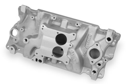

I swapped my crossfire system out for a truck tbi unit and holley tbi intake. With adjustment done to fuel pressure and ignition timing, it runs pretty good. It uses the stock computer and wiring to run it too. The throttle body I used was for 87-89 350 trucks. If I had to do it again, I'd snag a 350 vortec and adapt the tbi to it by using a carb intake and a tbi adapter.
