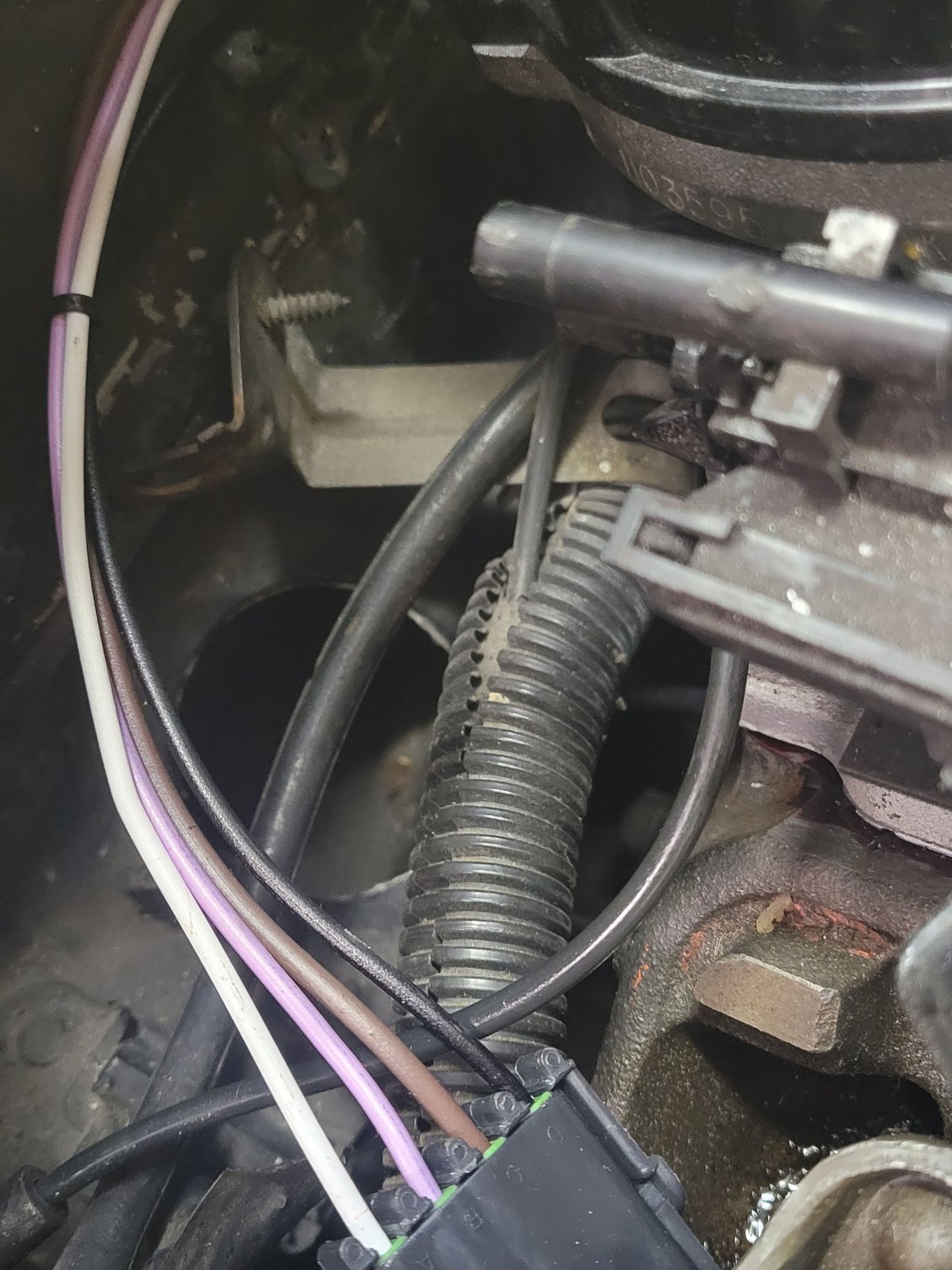

Anyone know where this bracket attaches. Its NOT part of the engine harness, its the C100 harness The way the hole on the bracket is bent on a 90 it does not look
like it will attach to the bellhousing or anything else in the area.

So that conduit goes behind the distributor and the wires go to the C100 connector where the engine harness plugs in? Engine aspect @ C100 is the smaller of the 2, The Forward Lamp Harness has the screw for retention of both.
***** Look at the FSM @ 6D-4 FIG 6D-3

I looked at page 6d-4 and at the top of the page it shows the manual transmission with a clamp to the bell housing to hold the engine harness.
But all of those brackets are flat with a hole. The one in the pic has a 90 degree angle. Still not sure where it attaches

Is the clamp fixed(secured) to the conduit where it's at or could it be easily moved? 6D-6 (Fig 6D-5) shows a clamp in the vicinity of the Oil Temp Sender and the conduit that run driver side of engine?

I think it can move. as you can see its near the harness hole in the firewall. Are you thinking of moving it to the side of the engine where the bolts would work with that 90 degree bend. I was thinking it might actually have gone to the egr relay/intake bolt. The ways its angled it might work. But if thats the case I will lust leave it loose, I
am not messing with that relay anymore.
