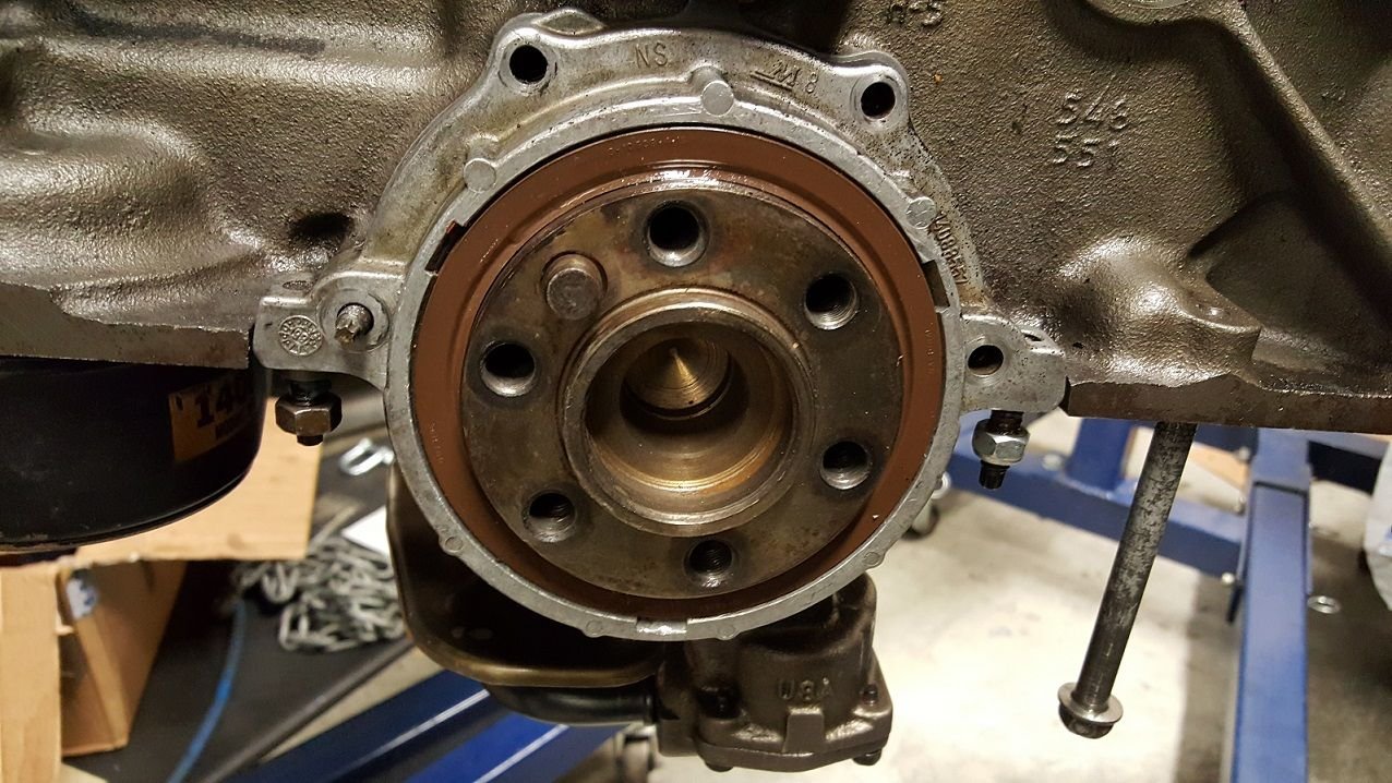

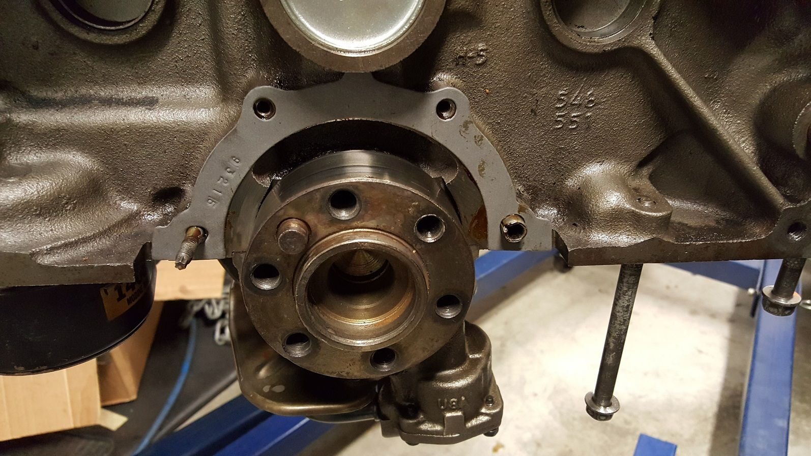

Alright after further trouble shooting, the cars rear main seal was put on incorrectly. I don’t know what I did wrong. Reading through forums and watching videos made me think that I should install it dry. Not sure if that’s the reason why it’s leaking.
Unfortunately I’ll have to take the transmission/bellhousing/clutch/flywheel off but it will go by faster now that I know exactly what I have to do.
As for my seats, they still don’t work. I’ll check grounds, fuses etc once the car is patched up again.

I always wipe the seals with grease on the first install.

By unbolting the Clutch Cover on the front of the Bellhousing You should be able to verify if the Rear Seal is leaking. I have had a a couple of leaks that "looked" like it was the rear seal when it was not. And after You have removed everything only to find nothing wrong with the seal ( been there) you will want to double check first.

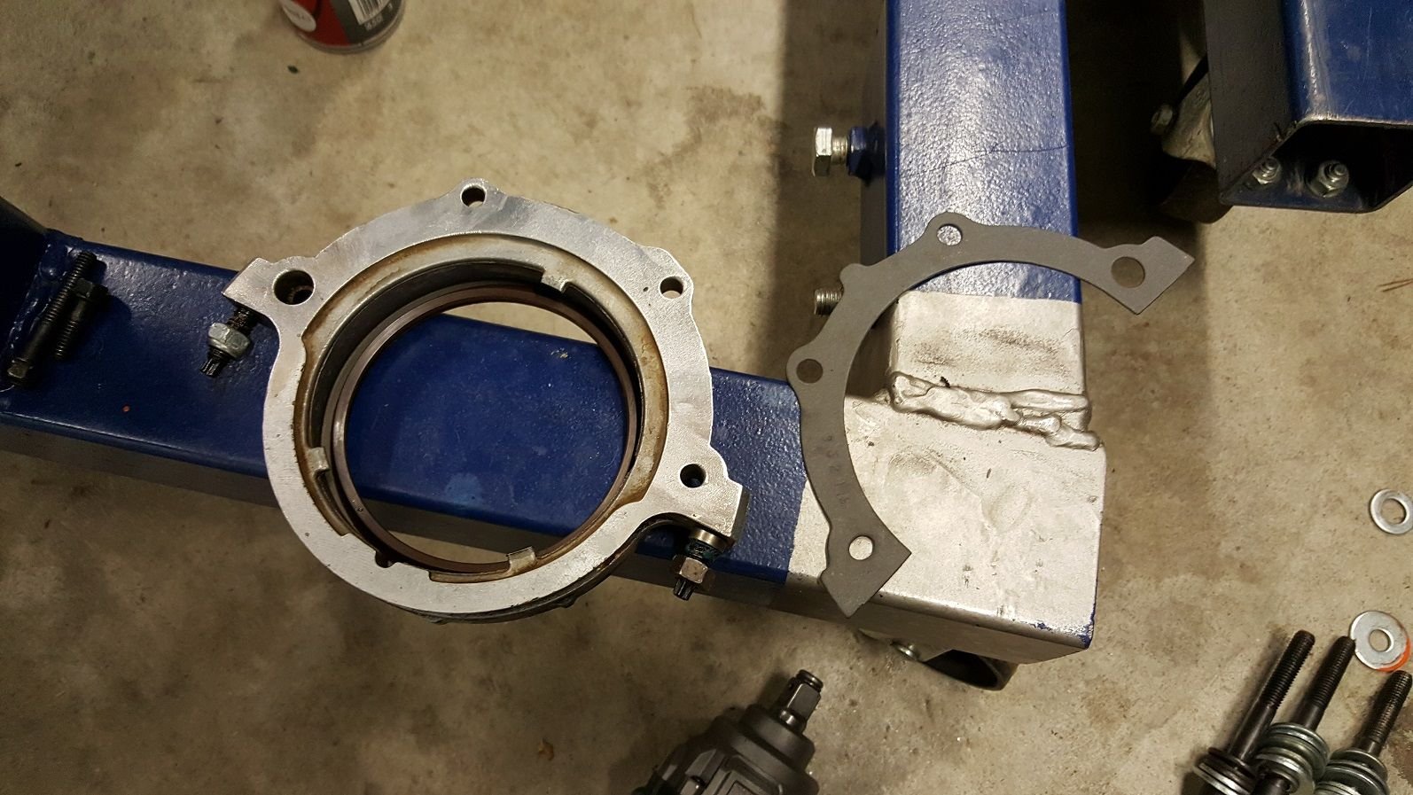

I removed the dust cover and saw some oil in there. I have everything out now and am ready to get the seal redone. Do you know any good brands I should use for the rear main?
Another thing to point out, I found a spring inside the last seal. I damaged it while taking it out. Although the one I bought never came with one, should I have that spring inside the seal?

I wiped the seal with motor oil on the first install. And just to be sure for the next time, only the inside of the seal right? I read somewhere that you should do inside and out.

I installed the rear seal dry.
And I was told not to use oil or anything else.
Have you checked that the "Chinese wall" is not leaking?
I was really careful with the installation.
No leaking

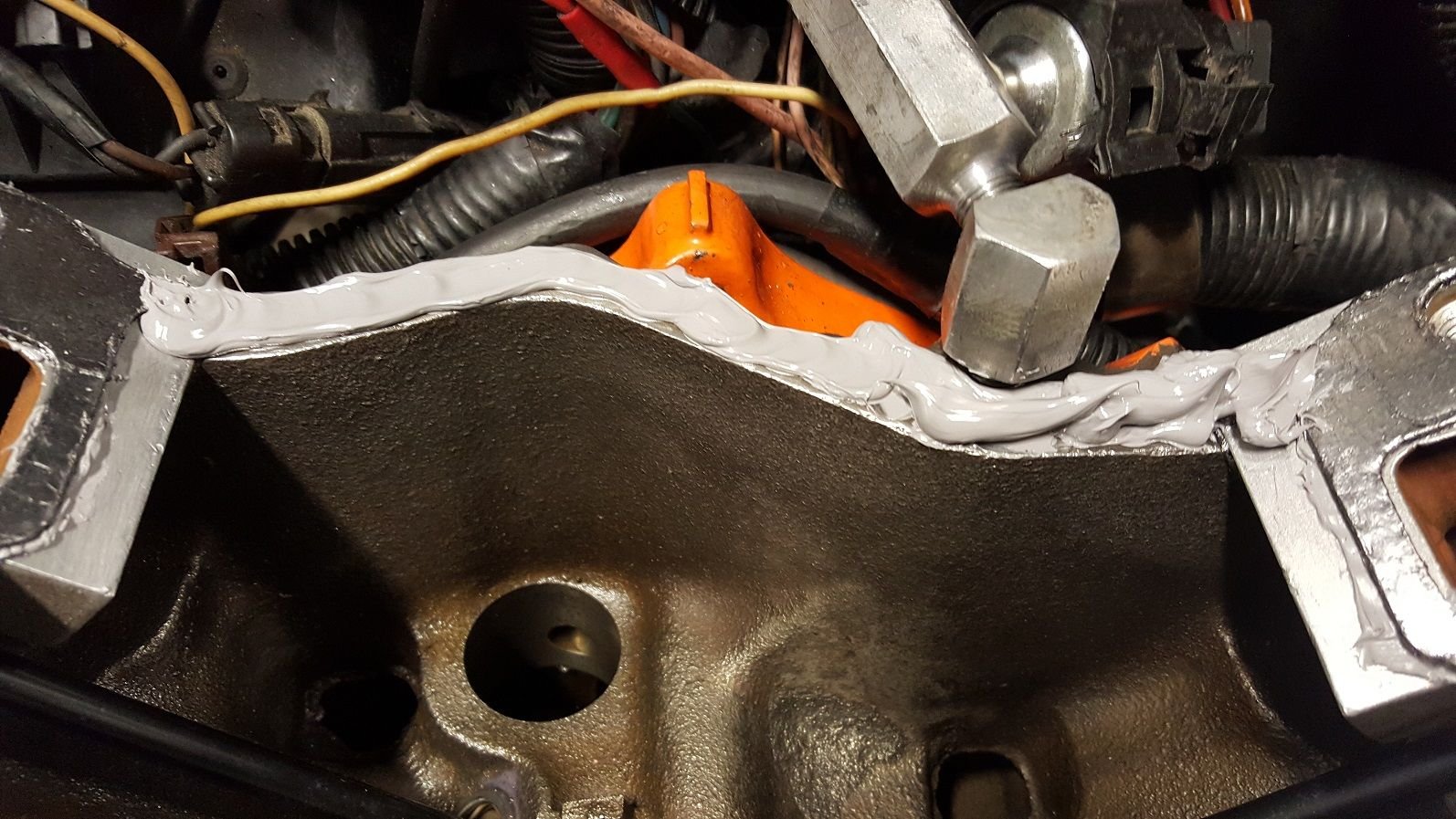

"China wall" is the saying on the front and back of the block.
I had a leak in the back and the sealant always has to be the right kind.
Pure silicone will not work.

Oh I see. I do see oil coming from that area in the back of the block. Although when I took a look at the rear seal it was indeed bad. So I guess my next project will be redoing is the China wall and my valve covers lol.

The Sealant which should be RTV in the above picture is not tall enough unless you know for sure the Intake fits low and tight to the Block. There is one or two Oil Pressure senders here that are notorious for leaking. Mine was leaking internally and the weatherproof Plug kept the Oil in it would travel down the wire until it found a break in the insulation. That one took a wile to figure out.

First off, there are no leaks. So I’ve done the rear main and oil pan gasket correctly this time.
