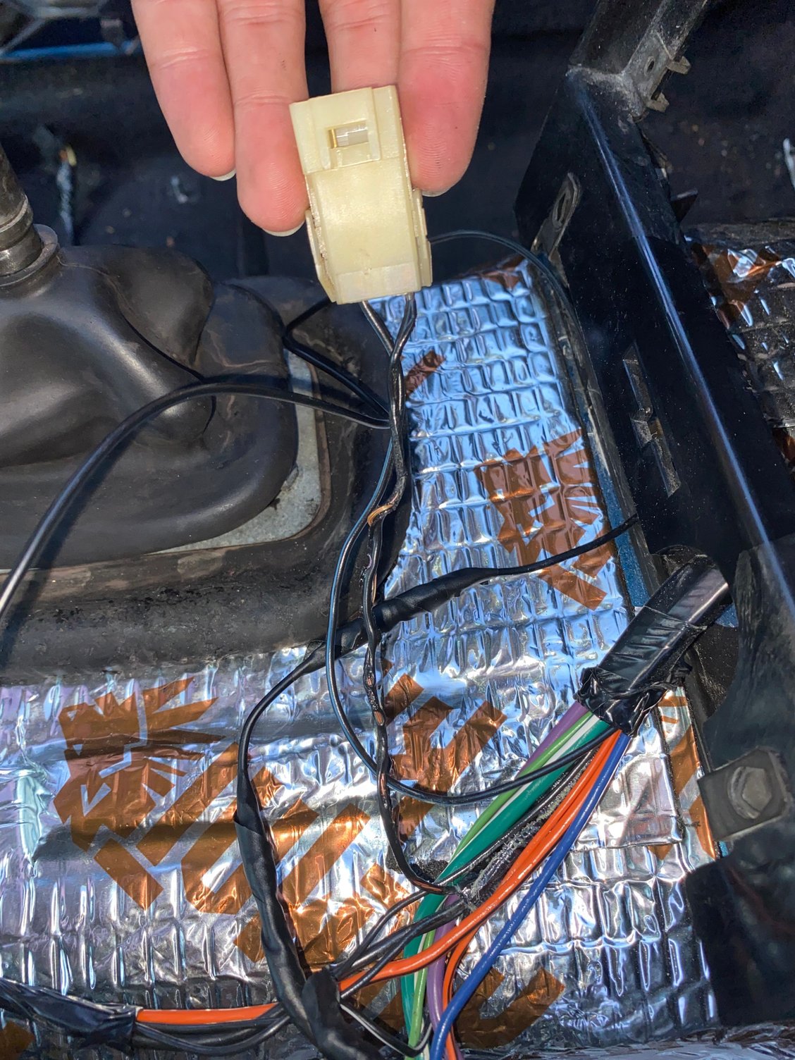

Update: Dug around under the dash and found that a connector had burnt through its protective rubber. I had left this alone during the rewiring of the shifter harness.
Is this part of the shifter harness? Should I keep it disconnected? The car cranks still if I keep it disconnected.
The other connector it’s attached to has orange/black-stripe wire on the A pin and black/white-stripe on B pin. The burnt connector has a full black wire on the A pin and black/baby blue-stripe on B pin.
Edit: Power seats and power locks work after disconnecting that burnt connector
