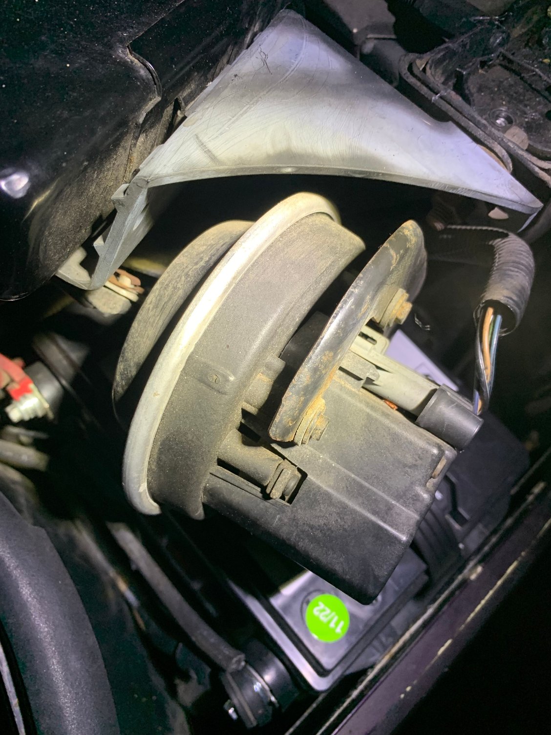

This is what it looked like after I got it off the connection broke clean off 😂 glad i had your help

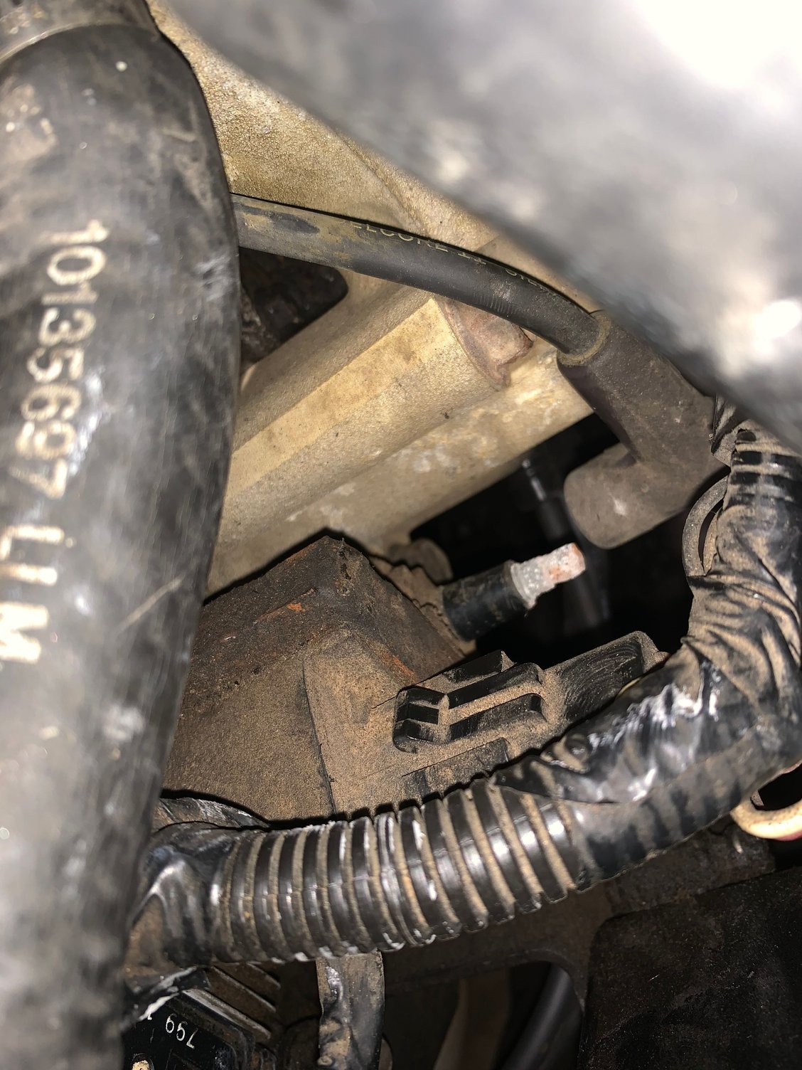

There’s the broken line

Vacuum lines and poor electrical connections are the usual cause of issues. Sort out the basics before firing the parts cannon.
Well that bad boy definitely gave until it hurts

I put the new one on and it runs like a new car it doesn’t stutter or anything I appreciate the advice
