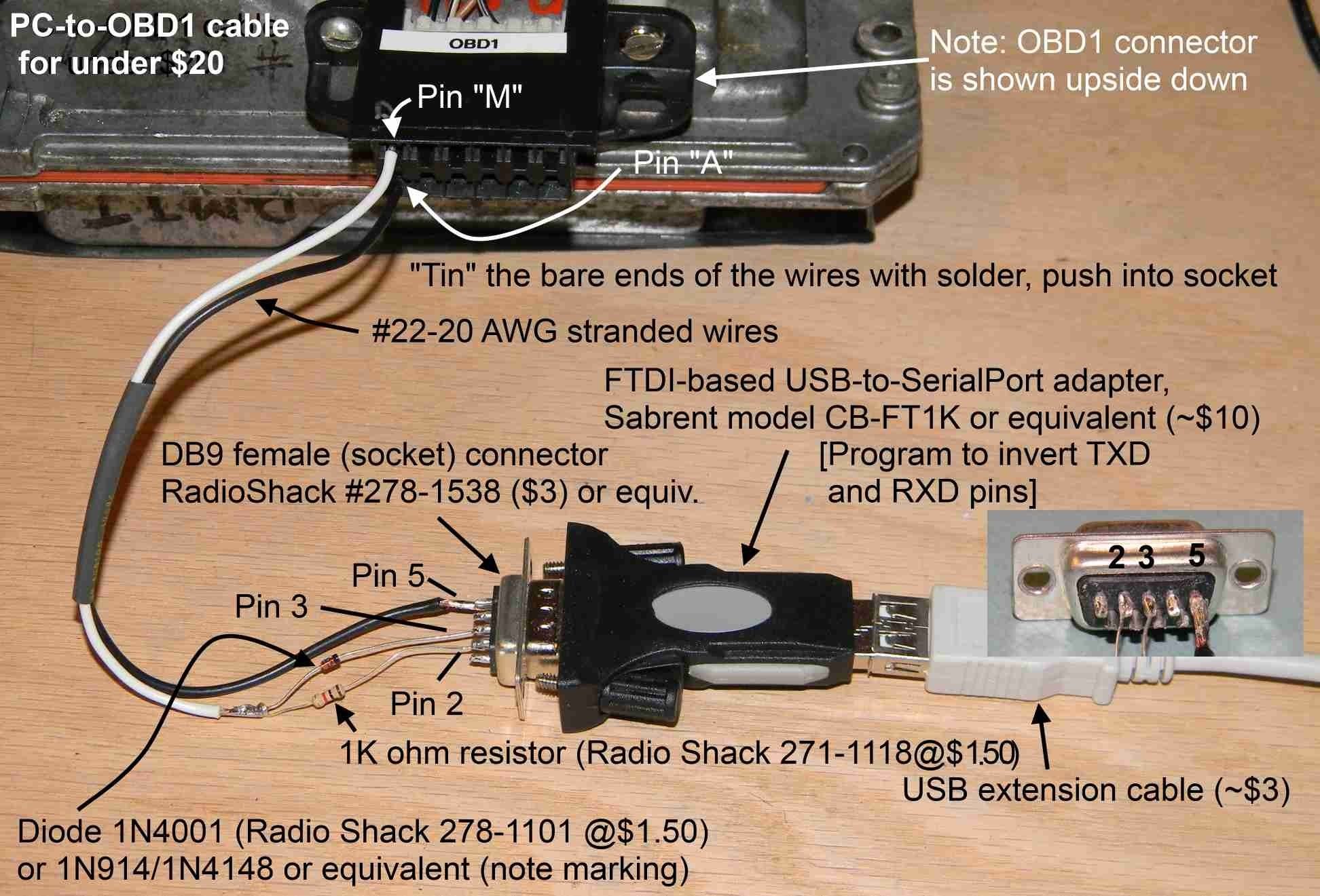

I hope the OP will pardon my question. I could use some help with a schematic for the ALDL data cable. I found one online but not sure I want my ECM to be my test bed for an online schematic. It's possible it came from this site. Some had transistors, and that confused me a little. my ECM is 1227165.

I think that is from thirdgen-not sure though. It is an older post-the FTDI USB to serial port adaptors are a lot more than 10 dollars now. It's been a while so off hand I don't remember which resistor is for which baud rate. The older ECMs had a slower baud rate and required a different resistor. Personally I just bought a cable premade-it has a switch on it for different baud rates.

Thank you drive it for the help, my ECM is 1227165. Not that I don't have the money but am trying to trim my 87's appetite for it. Making a cable would help that by appx 60 bucks.
Adding to the confusion a little is the FSM calling out a 10k mode and the mention of 10k ohm resistors, lots to figure out between the cable, Tuner Pro and the data.
2nd Update, looks like the cable shipped is appx 80 bucks.
