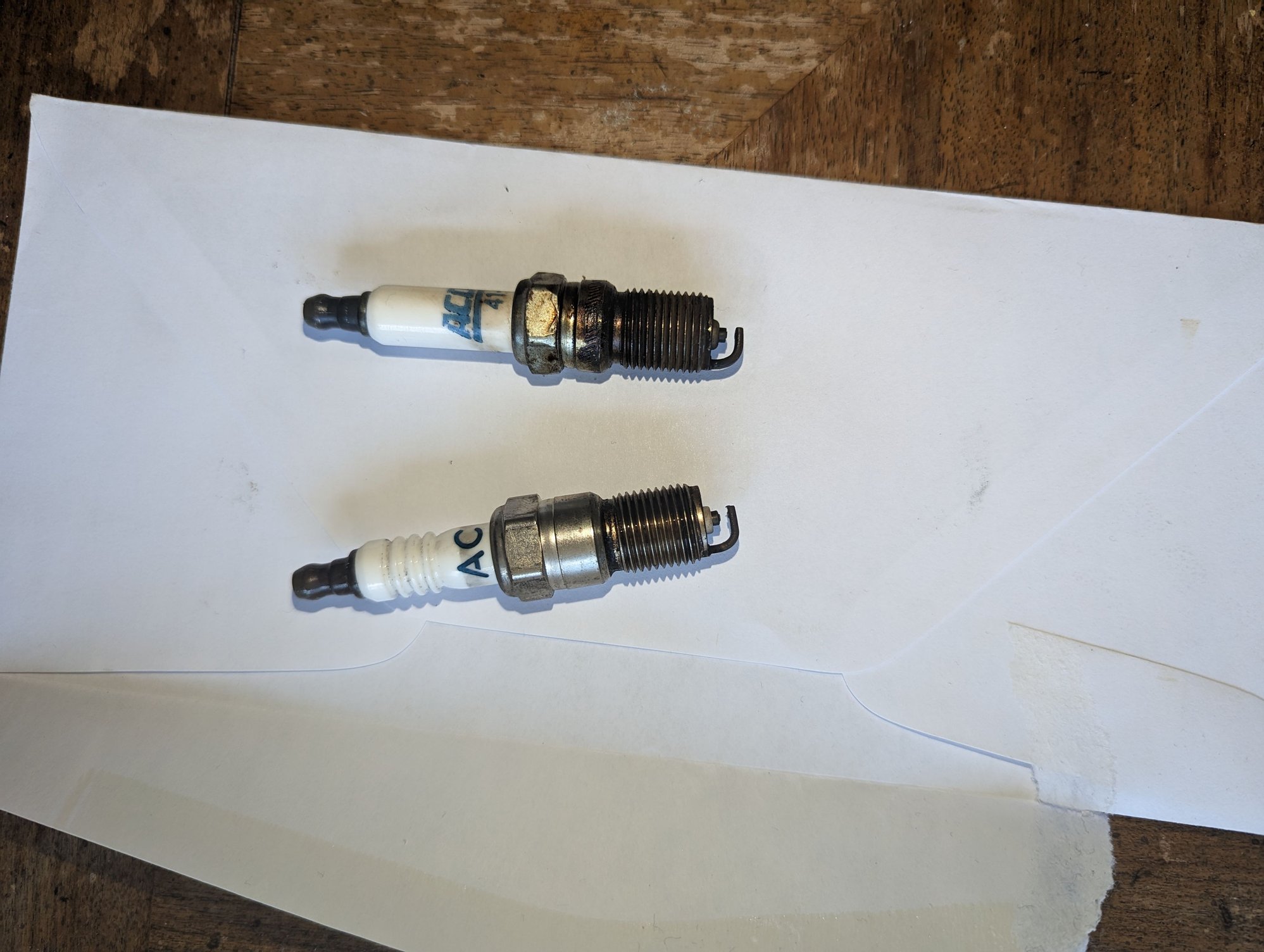

So I pulled a couple plugs: the one on the top is the one that was misfiring the worst. It was not very tight, does that matter? I ordered new plugs and wires so I'll start there. These plugs are the ac Delco double platinum plugs, does that matter? Like I said I ended up getting spark on that #3 cylinder, but it's still not running great. I wonder if there are multiple misfires or a weak coil or something? Any help is greatly appreciated!

Plain copper plugs work really well. No need for fancy here. If you have an obvious ignition issue with one cylinder truly seems plugs/wires are called for.

Looks like the bottom plug is original. The top plug looks to be a new plug, which is odd it's worse looking but that could be because someone forgot to torque down the plug. At this point all new plugs is a good idea. You can do the plugs and run it again to check status. Plug wires are quite a bit more involved but not overly difficult on the LT1.

Hey y'all thanks for the advice! Djpink, I'll put the new plugs in first and check it. I have the ngk Tr55's or whatever. Jmgtp I used to have something like that wire for my old car, that was nice. I'm fairly computer savvy, so that would be a good thing to get. What cable should I get? Is it possible to use that on other cars also? Again thank you all so much for the help. What a bunch of nice people here.

Hey y'all, just wanted to give an update on my Vette. I did the plugs and wires with MGK tr55 and Taylor wires and now it runs great. Thank you so much for all the help. There's a bunch of cool people here!
