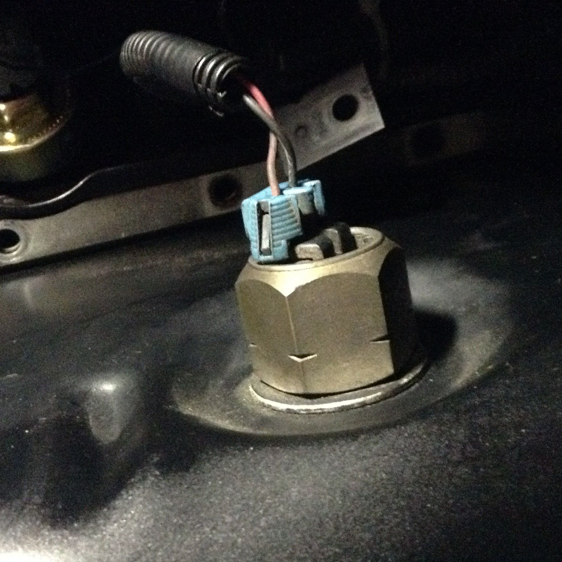

Any of the low oil level sensors I have ever messed with were always just a basic float switch. In the newer V8's (LS3 and up) GM put a thermistor in the float switch so it could also read oil temp. So you should be able to just connect the two wires together that went to the old sensor and the light should go out. If there is only one wire then connect it to ground.

is this what i’m looking for?

It sure looks like it. Jam a paper clip in the connector so it connects the wires together and see if the light goes out. If it does then cut and solder them together.

this was a stock image! i’ll crawl under there tomorrow. thanks!
