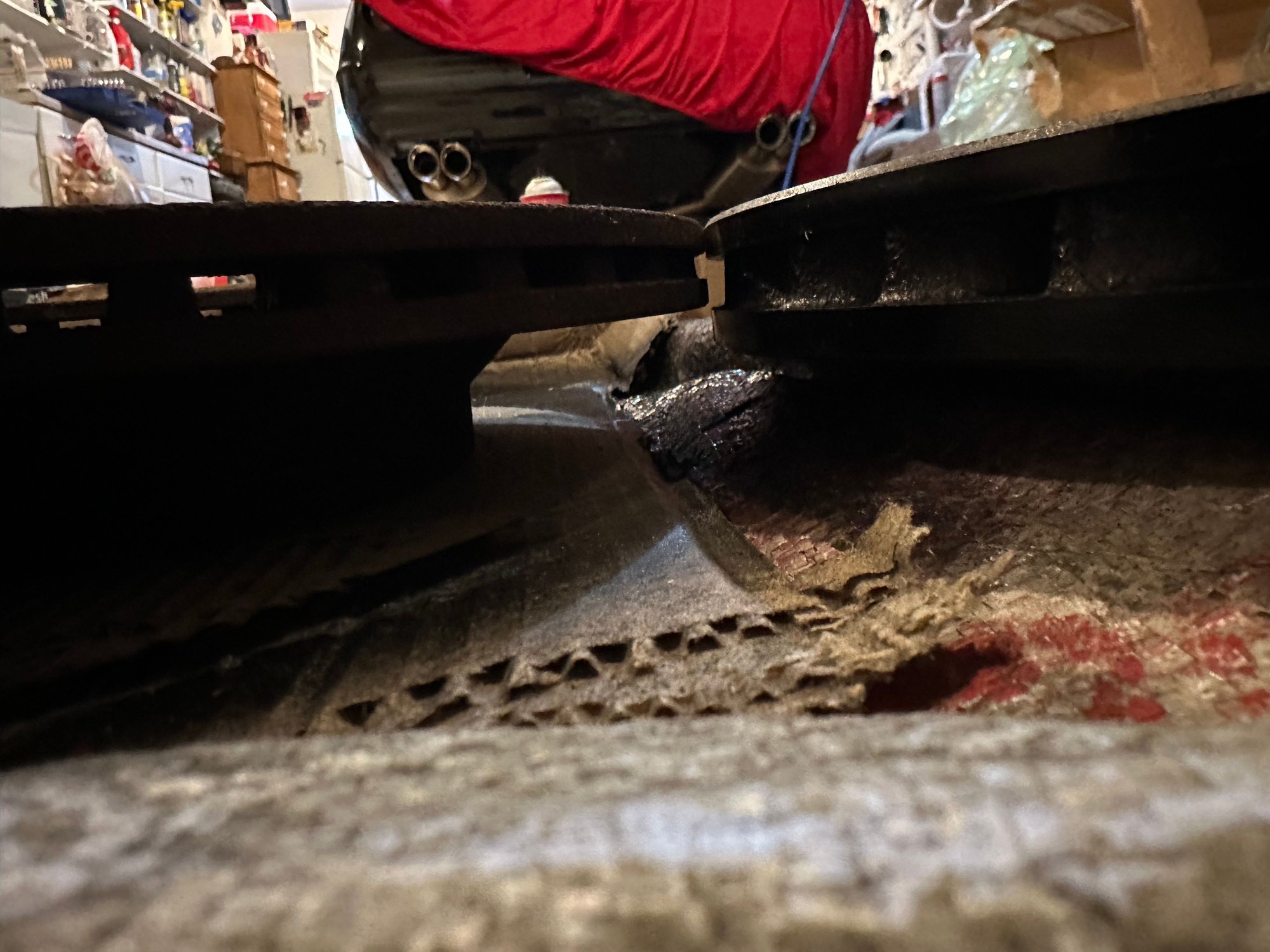

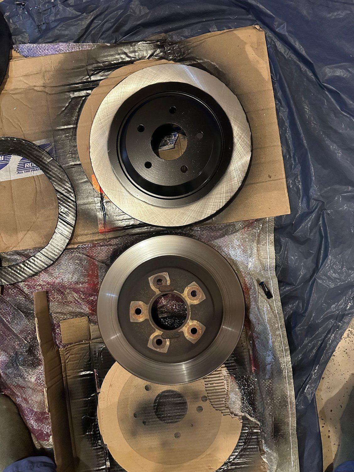

Yes the J55s are much beefier than the JL9s. 13 inch vs 12 inch rotors and thicker. Pads are exactly the same though!
Some vs pics:
