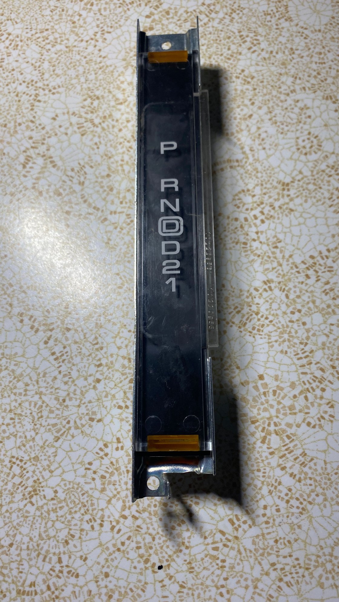

Top view of gear indicator
Bottom view of gear indicator
Does anyone know how this automatic transmission indicator attaches? I cannot find any tabs or screws on the plastic console to attach this piece. It was like this when I bought the Corvette and makes it hard to see what gear one is engaged in because it is sunken.
Do I need to buy a new console piece where the automatic transmission indicator plate attaches?
Thank you in advance.

You're missing the little orange indicator slide

I have that part. Just did not include in photos. Problem is attaching the piece shown in photos. Thanks.

Two screws and one light bulb/socket. You are probably missing the push nuts that go on the console. If you replace the console you have re-use the old nuts.
Try this thread:
https://www.corvetteforum.com/forums...-question.html
You can also get them from Corvette Central.
