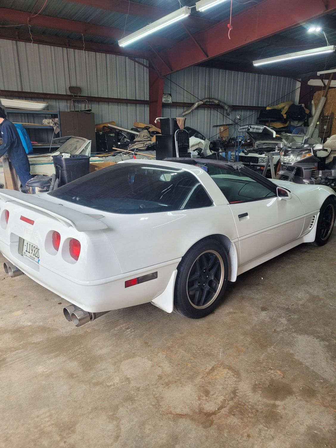

Have you looked at the engine bay? Look for wire splicing, things that have been removed or out of place. Also, look for nuts and bolts with a worn ou t or chewed up head... That would mean it was removed at some point in the past. Particularly important around the intake and heads. It would signify the engine has been opened up.

Gotcha. I did get this picture, but I'm going to have to take another look.
