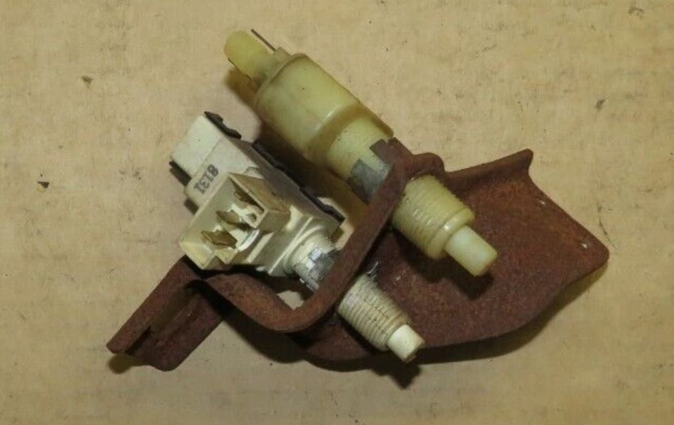

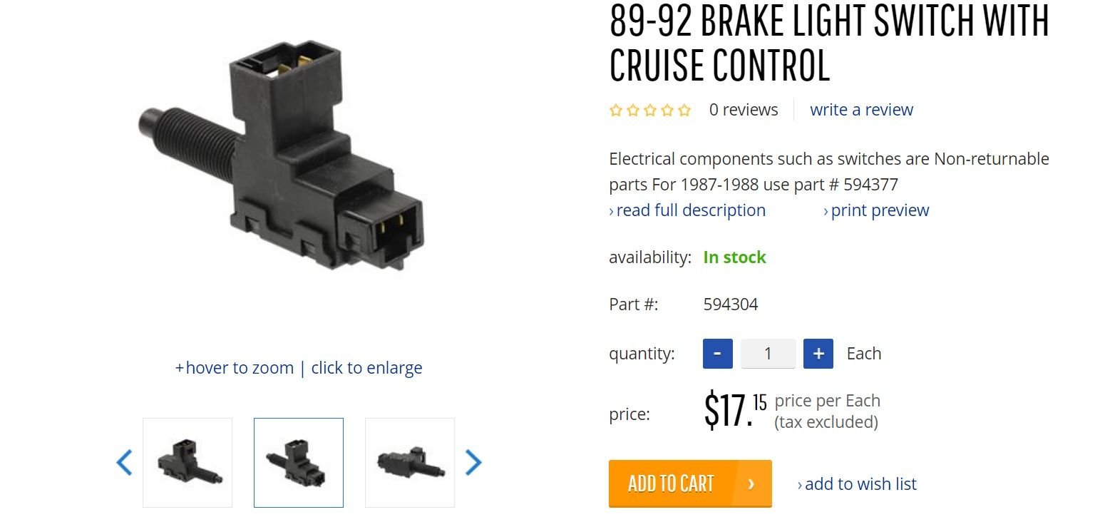

At 68 with four discs fused with rods and screws about five months ago I’m trying to fix a no brake light problem, not that anyone is ever that close lol so I’m using a like a miners light and a mirror and I get the so called switch out and my new rock auto switch has two plugs and this thing I took out has one plug and a vacuum line obviously not the brake switch so what did I brake my ***** taking out? 1990 six speed with cruise control, so I’m thinking something to do with the cruise control? Pics incl
What I took out left new rock auto brake switch right
uded

This is a '90 SLS. You can use this GM # or any after-market that mentions a cross reference to this GM. I can't see your images but I suspect you ended up with a cruise control release removed and if what you received matches this image it's likely correct.
*** What are you trying to fix? No brake lights?

Is it possible there are seperate switches for cruise and brake or different configurations for manual 6 speed? ?
https://www.corvettecentral.com/5943...iABEgLolPD_BwE

Originally Posted by Vets-Vet
Exactly what I have and like an idiot I took out the largest one on the right fun fun fun
thank you
