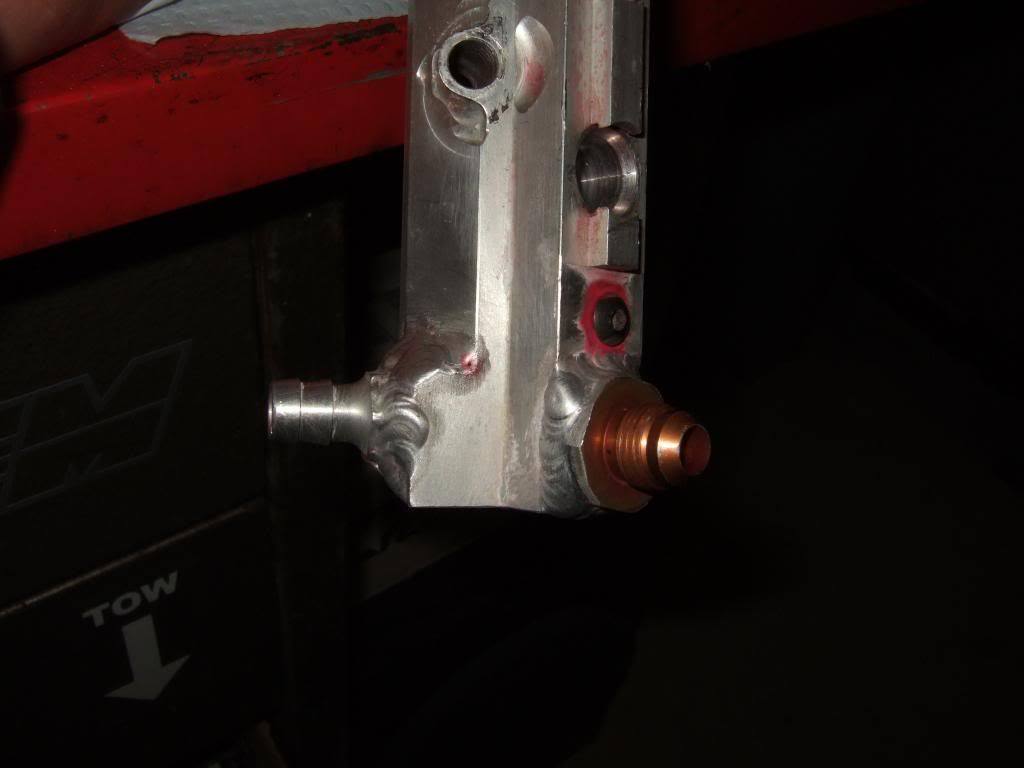

One combo I had used 46# injectors on E85 and had almost 400 rwhp but I did mod the rails a little. They are odd in that the fuel takes a Z shaped path through each rail. I drilled through one layer so the path to fill was shorter. I also added AN and other fittings instead of the o-ring stuff. I have seen aftermarket rails used but I don't remember all the details or HP limits. I attached a picture after welding and leak checking.
thanks, thats helpful, that way I can have a remote regulator and run two lines to the fuel rails. Not sure if they wanted to cool the fuel as much as possible with the flow path, I’m more concerned about even pressure/flow with high demand situation. May drill a 1/4 hole at each injector to the channel above and deburr. I have a fuel injector flow bench and noticed that the location of injectors relative to supply would influence flow +/- 2% depending on the duty cycle selected, more flow the more delta, so it seems on the engine the RH bank would get more fuel with the forward injectors getting more fuel. I can wire up EGT’s and trim per cylinder accordingly, just don’t want to go through the expense and the hassle.
I thought about that dual feed style but didn't get to it. It's really a nice setup! Good ideas and yes the top layer being for cooling is an interesting thought. You could try drilling one side like I did and the other each injector then test. It would be interesting! This is all going back quite awhile I used something sized like 3/8" to drill through the layers at the o-ring fill locations. I would have to reexamine some of the rails to remember better I think. Isn't it interesting though that there is a layered flow path in the rails? By looking at them you would never know and it wasn't much talked about.
