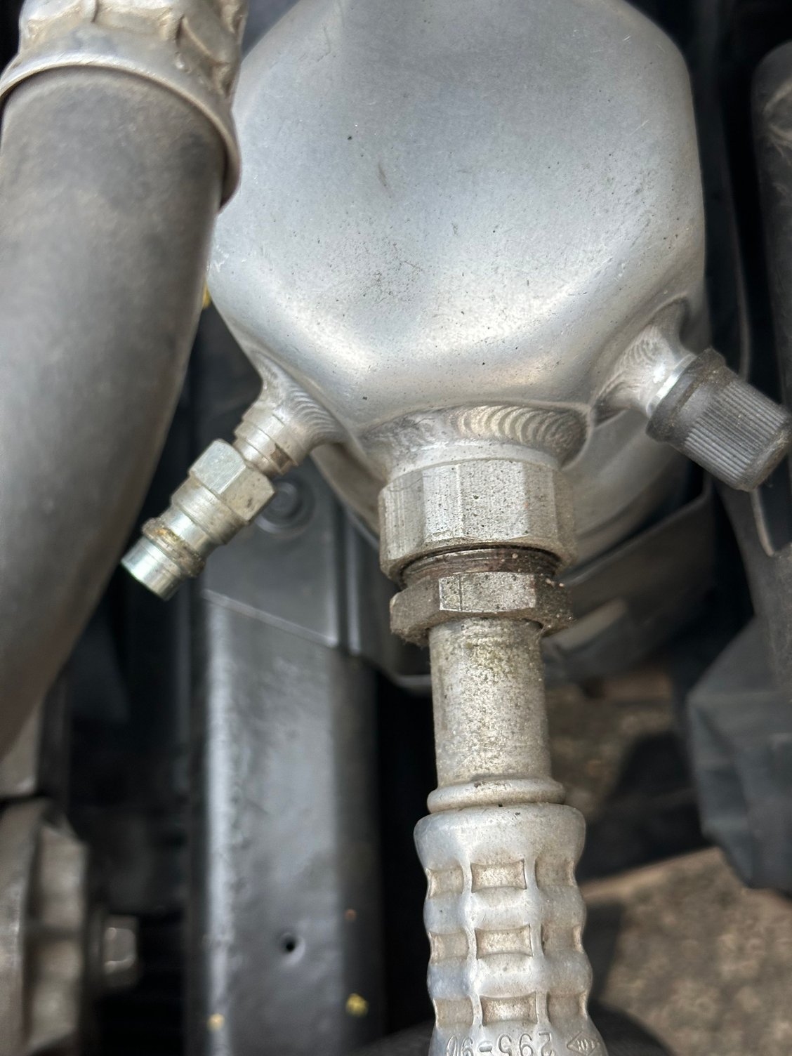

I’m having trouble figuring out if this is a R134a or R12 port. Any idea? looks like R134a to me

Low Side, is pictured
High Side should be RF wheel inner wheel well in the area of the Upper Control Arm

No one seems to have answered your original question. The car was R12 when manufactured and someone converted it to R134. As others have said, put a can in and we if the clutch engages. Watch for leaks, if no leaks, continue to charge till system operating normally.

I sort of figured it was r134 after comparing stocks parts to mine. I also got the feeling i was overthinking the whole process and maybe need to just throw a can in there.
