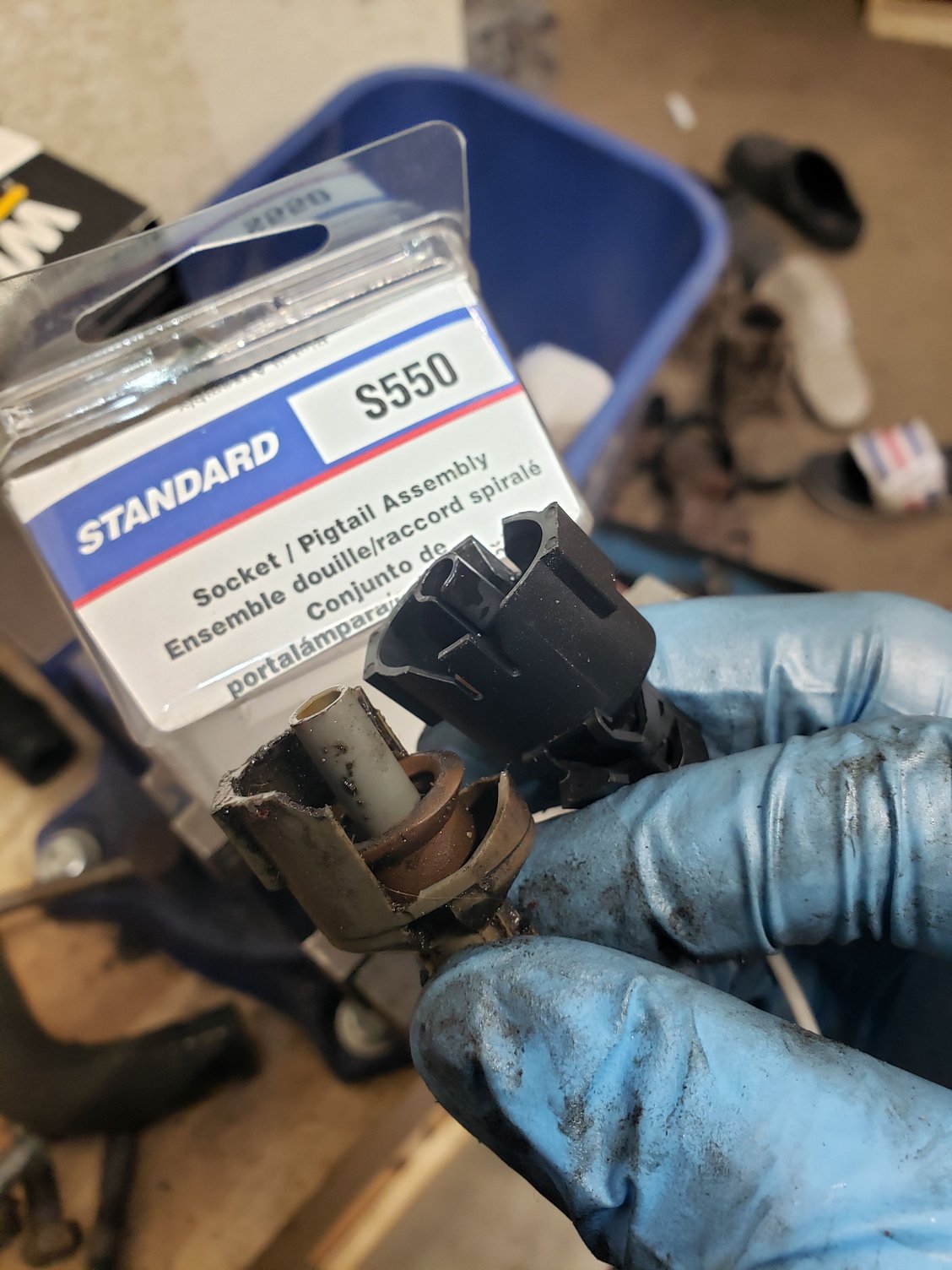

The knock sensor connectors are indeed brittle!
I broke one the other week. There are replacement connectors at the local parts store, but you gotta solder or splice it on. Picture related!

You could try to release the pin on both wires (stock wire and pigtail) and swap on the new plastic connector onto your stock wire...no splicing!? Unless that particular connector doesn't work like that, but probably not a bad idea to splice, if that few inches of wiring is hardened and heat treated/melted from exposure to the exhaust manifold👍

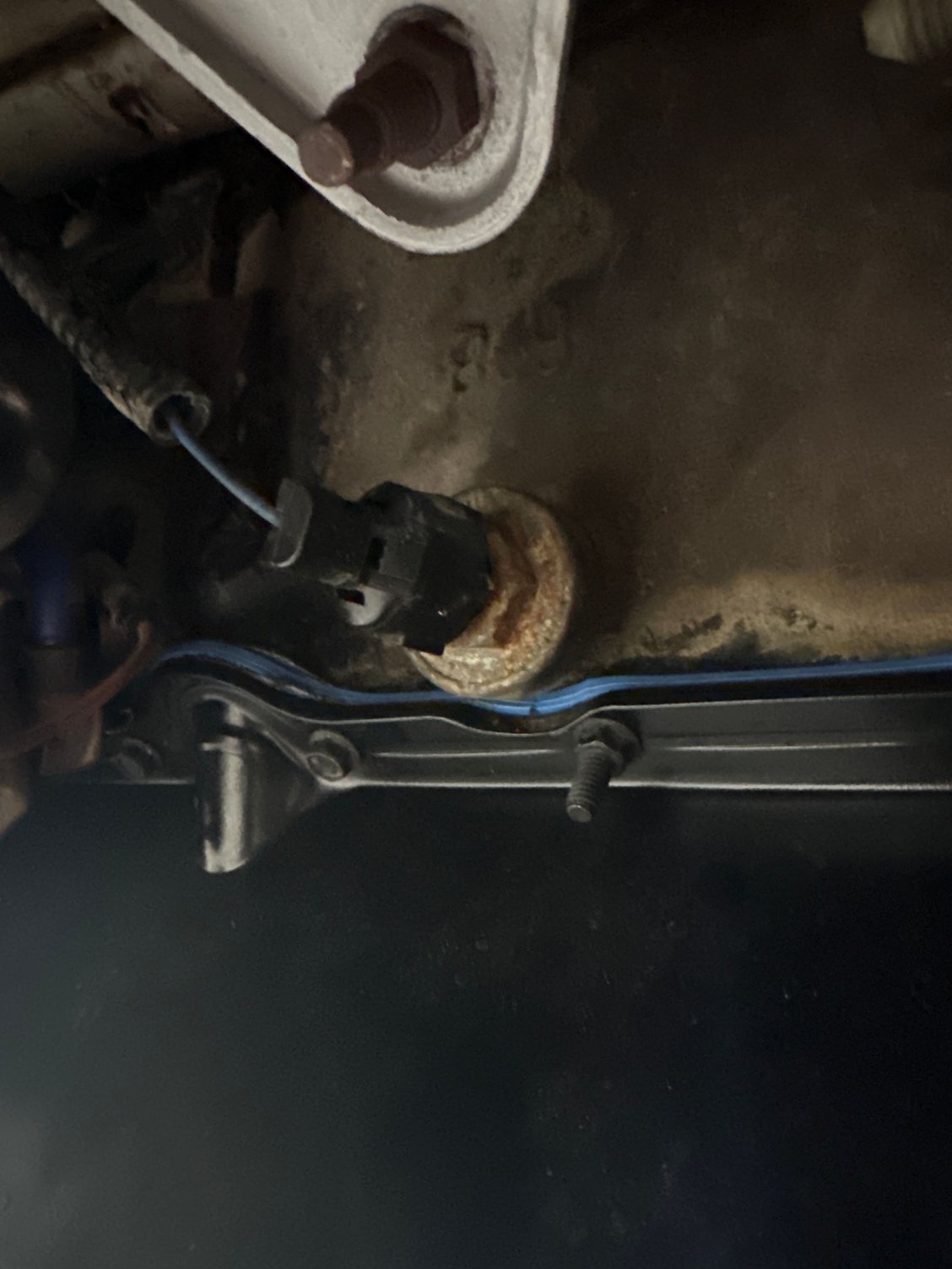

Default KC4 is the rpo code. Check your rpo sticker to see if you have it.
kc4 oil cooler if your car is equipped:
note filter has been removed here. those hoses…the one that goes to the block can be removed and out comes the driverside fluid. a very good idea to do this.
Now, if you do *not* have a kc4 oil cooler, then you will have a plug like this where the kc4 nipple would be: the socket size to remove is a 9/16 on mine. picture:
On the passenger side, here is the knock sensor. And it uses a 7/8 socket. i think. you want to be sure you use the correct one.
if you remove thise and nothing comes out, you have scale/sediment built up. You should take a small flathead and pole through the scale and out the fluid will come.
