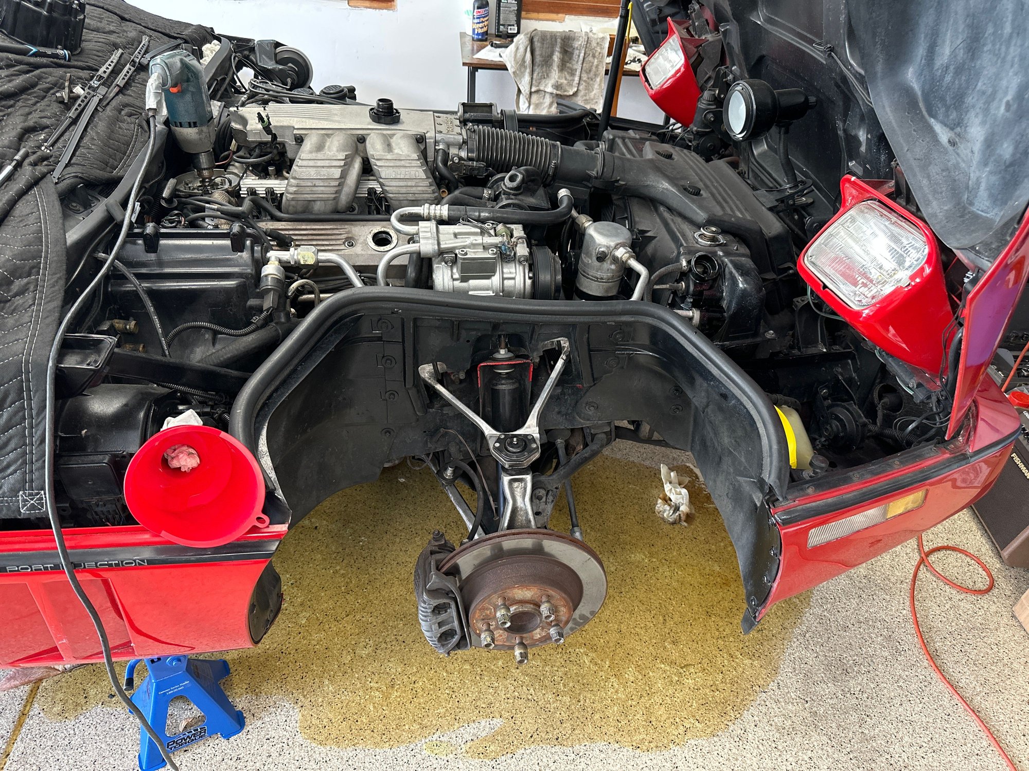

So I’ve been rebuilding my ‘88 L98 after a spun rod bearing.
I didn’t prime the oil until I already had everything installed. I spun the oil pump and a ton of oil spewed out of the radiator. I haven’t a clue of what I missed and I’m devastated. Frankly, embarrassed to even air it here, as I look back and realize I should have primed the galleys before I got it off the stand.
How do I troubleshoot this? What do I have to do?

Ummmm? Bad oil cooler?
Disconnect the hoses from the rad and prime again.

Good call on the oil cooler....
That's about the only HP oil-to-water interface that I can think of, too.

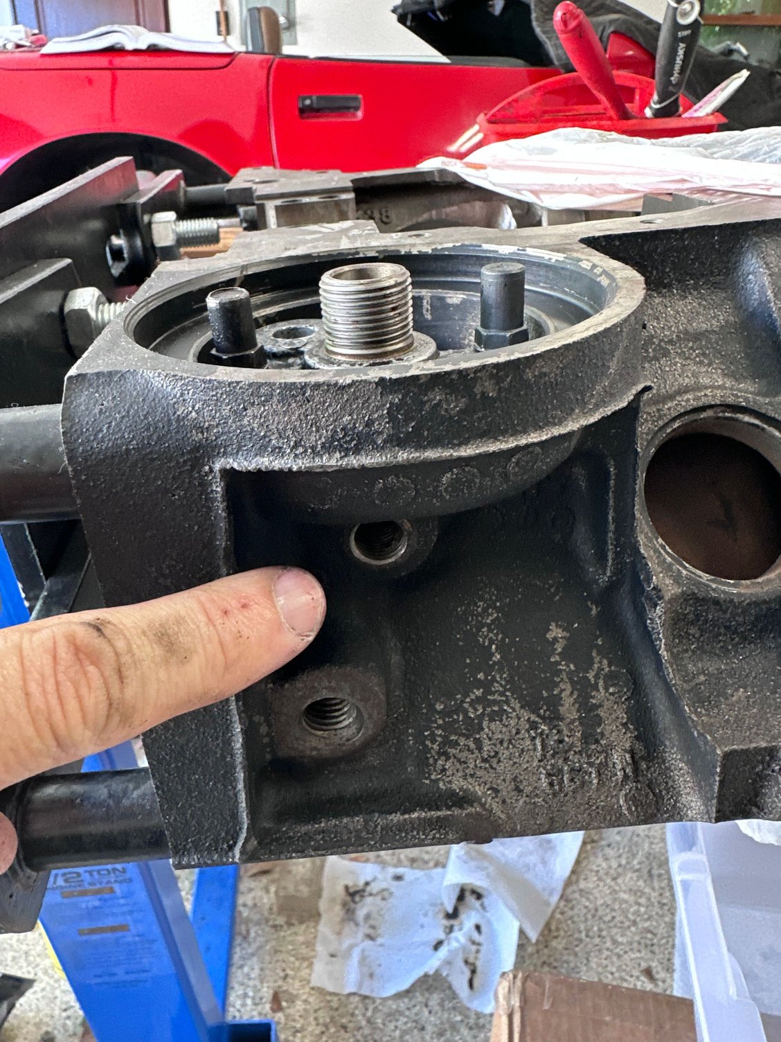

So now I’m suspicious that I routed the soft hose wrong. Does anyone have pics or can point me to the section in the FSM that might show me the right route? Here’s where I attached the soft hose
Isn’t that the oil temp port?
dammit.

Your KC 4 oil cooler should connect to the drain on the bottom of the block, the port above the oil filter is for the oil temp sensor.
Ah! Thank you, I somehow overlooked that page in the FSM... argh!

Yeah, the pump should provide enough resistance (once primed) that it can be difficult to hold the drill (a good corded drill), and it should REALLY bog the drill down.
If the drill is whirring along w/low load, keep priming.
You could pull the oil pressure sensor to see if you got oil...but be warned; when it starts pumping, it's gonna be a geyser! You could also pull the same plug that you had plumbed to before, in your pic above.
