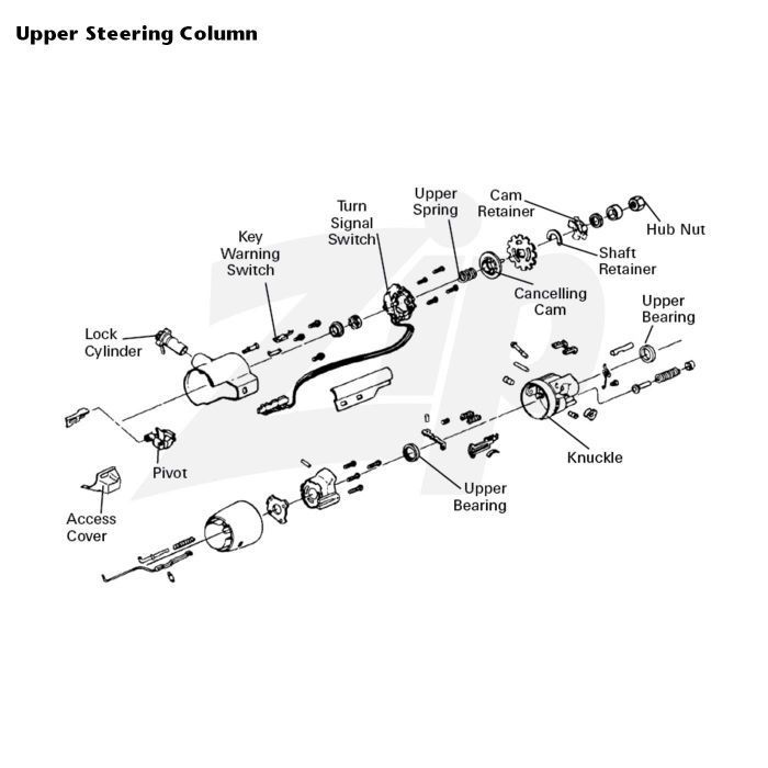

I think you’re gonna need to get into the steering column all the way down to under the turn signal switch. It’s doable but you’re gonna need some patience.
Here are some diagrams that I lifted from Zip Corvette when I had to dig into mine. They should have your part too, though I imagine it’s a common enough GM part that most parts stores would carry what you need too depending on what broke.
