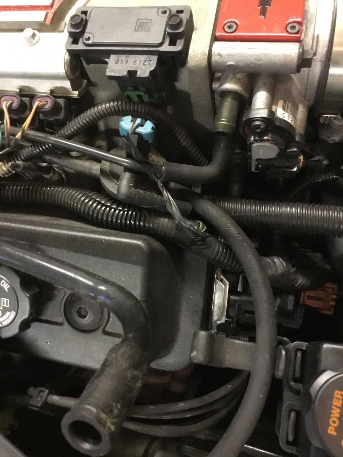

Can someone identify this hose? '95 Corvette (LT1/4L60E). I recently removed and installed the engine, and I can't figure out where this went!

It's the Evap tube from the cannister (right rear of car) to the EVAP Solenoid that you can see in your snapshot I believe. In the FSM Book 2 see 6E3C-C3-3 and it should also be displayed on the emissions routing label. Also in Book 2 you could check 8A-201-8 Fig 16

WVZR-1 is correct

Thank you both!
