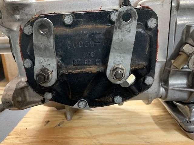

.My '87 has only the one switch on first gear, see the photo below
The '87 does have a Ist gear switch, this prevents Ist gear OD engagement.

this is a '87 DN, note a Ist gear switch on the side cover plate. The Reverse switch (brown connector)for the back-up lights can also be seen

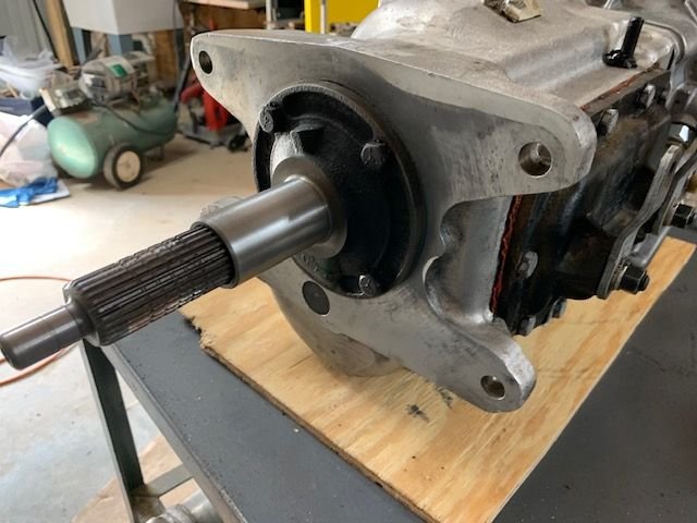

This is a '87 OD unit

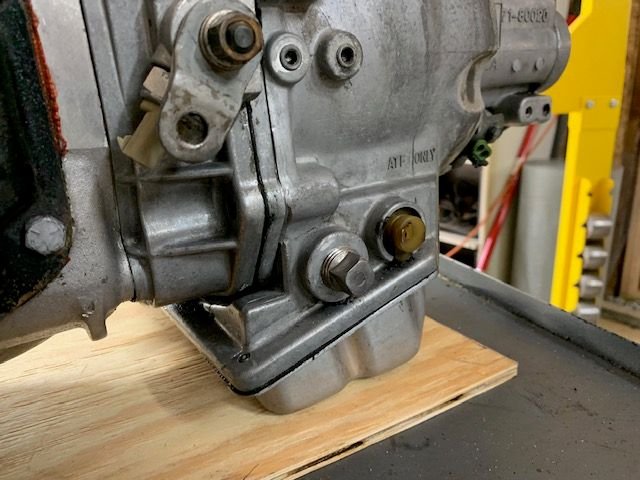

This is a side view of a '87 DN with the OD. It's been several decades since I puled an early C4 DN, so I can't tell you much about the early DN trans other than the side covers which are steel should be able to be swapped.
