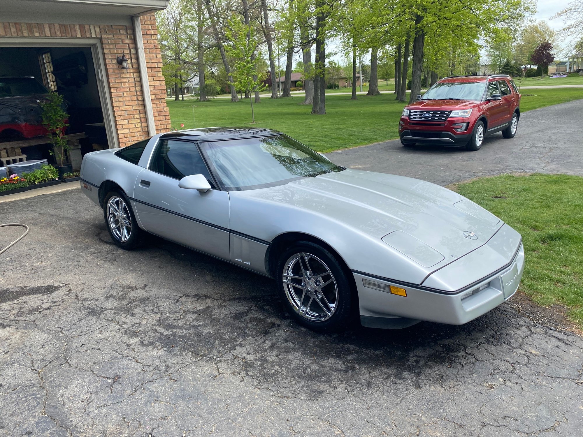

Here is my car with the 4+3 trans with 78,000 miles and c6 Z06 rims, she ain’t perfect but she sure is a pretty driver.
