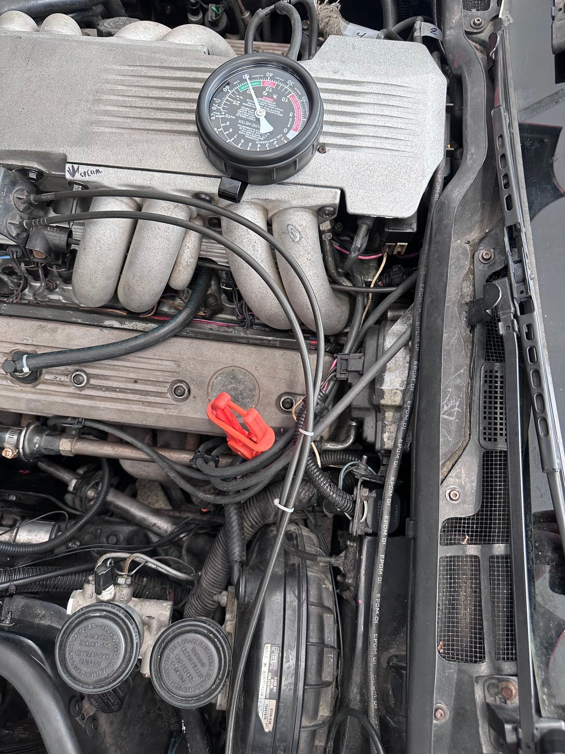

Symptoms:
- Pedal travel when engine off or on is about 2.5-3.0”
- In gear (R or D) have to stand on the pedal
- At idle, plenum vacuum wavers around 40
- At idle with booster vacuum line pinched, vacuum is 50 and steady.
Does that mean I need to replace the booster? Can it be repaired?
Vacuum wavering around 40
Vacuum solid at 50 with Booster vacuum line pinched

Couple of easy tests, with car off pump up the brake and hold. You already proved you have Vacuum
Start the car does the pedal drop yes or no
if yes the booster still has Some life left in it.
next with car running door closed rest foot on brake litely, is there a very noticeable Hiss if yes it's Dead time to find Booster.

no drop. That confirms for me. Just going to buy a new one, be done with it. Thanks @s carter
