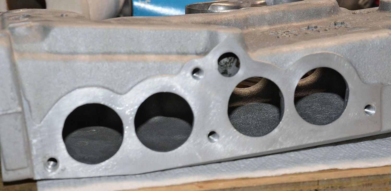

Originally Posted by Vets-Vet
I used Crud Kutter then NAPA aluminum brightner (caution mild acid). Easy peezy .
did you remove the electric sensor before cleaning? I was olanning to but wasnt sure if i needed to.
Old Aug 27, 2023 | 08:02 AM
  #35
Vets-Vet's Avatar
Vets-Vet
Joined: Jul 2022
Posts: 1,805
Likes: 365
From: Central Florida
Yes, all sensors removed and all parts removed from engine.
