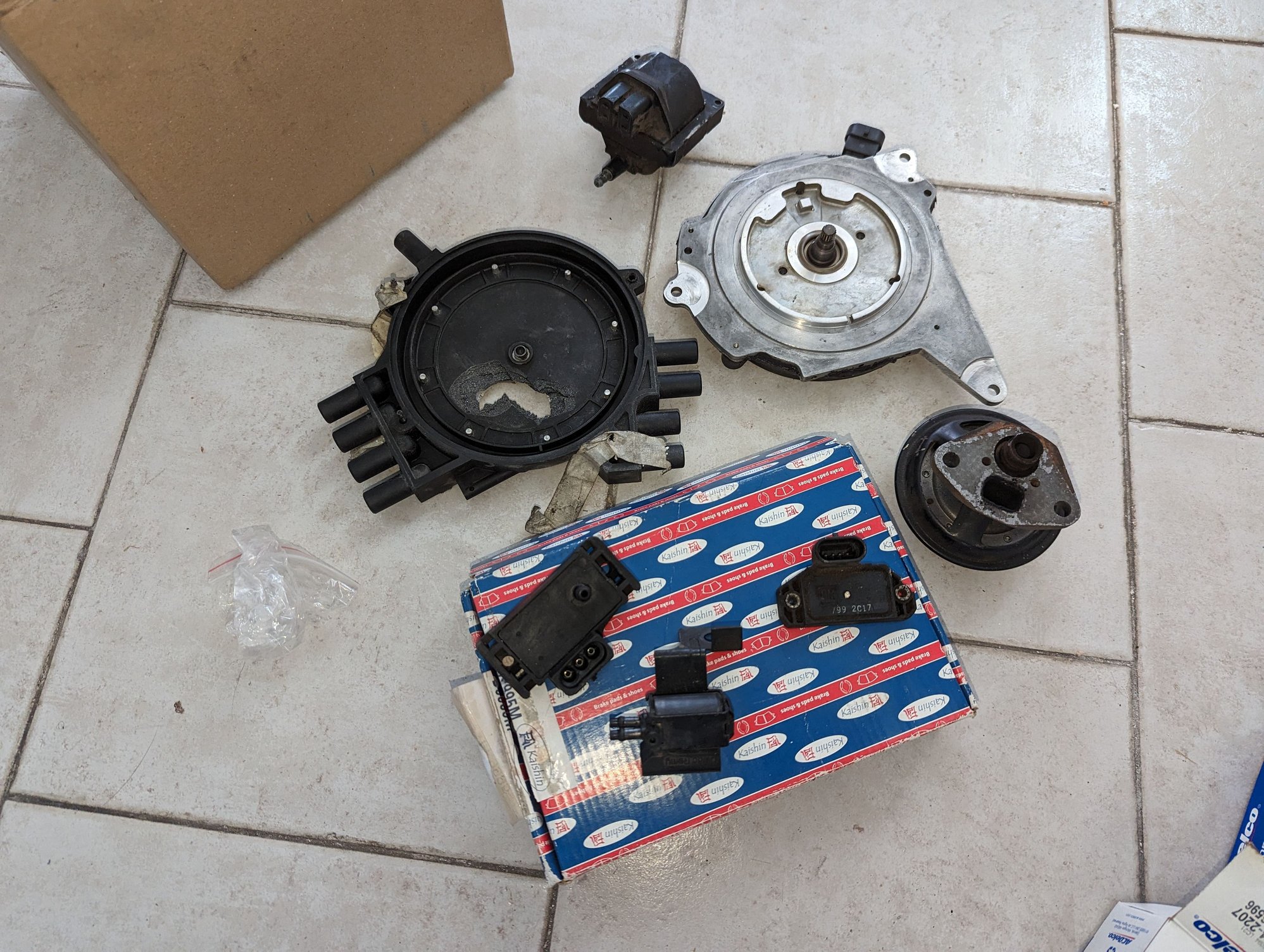

Yes - it is the module to the left of the EGR valve.
what’s the story with that opti? How did a hole get blown in it? Did you recently swap a bunch of parts?

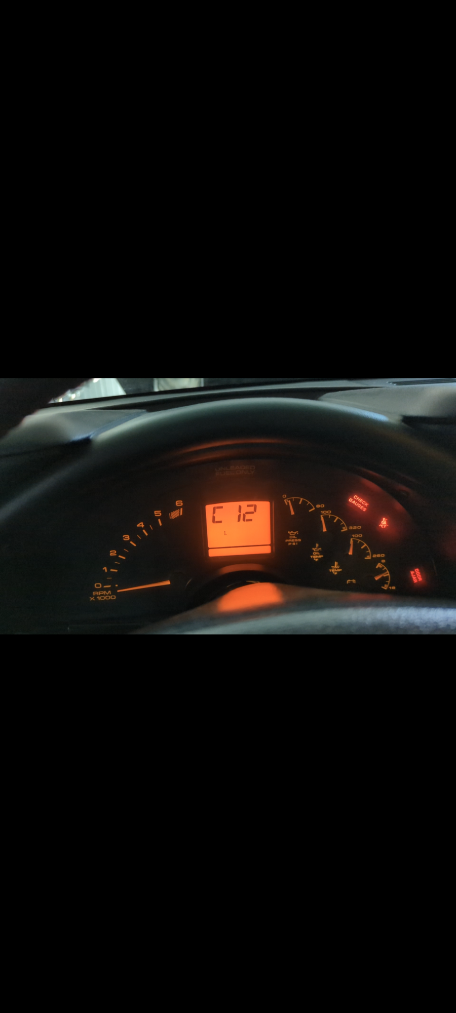

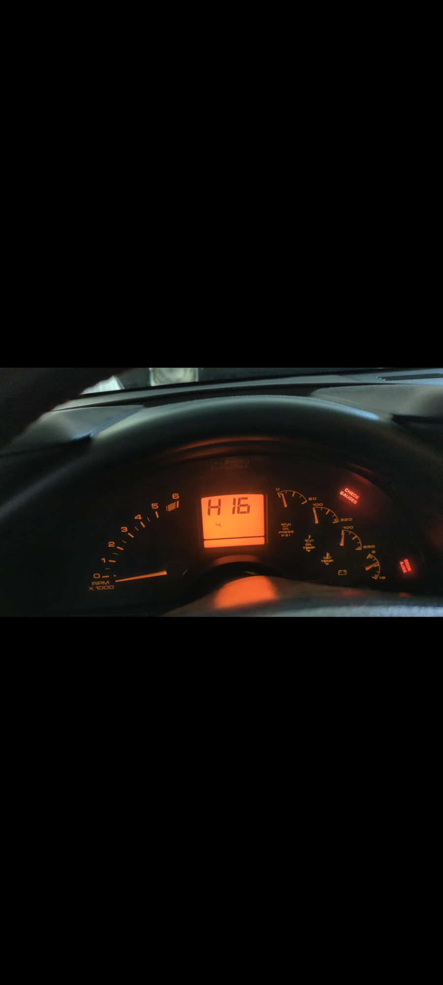

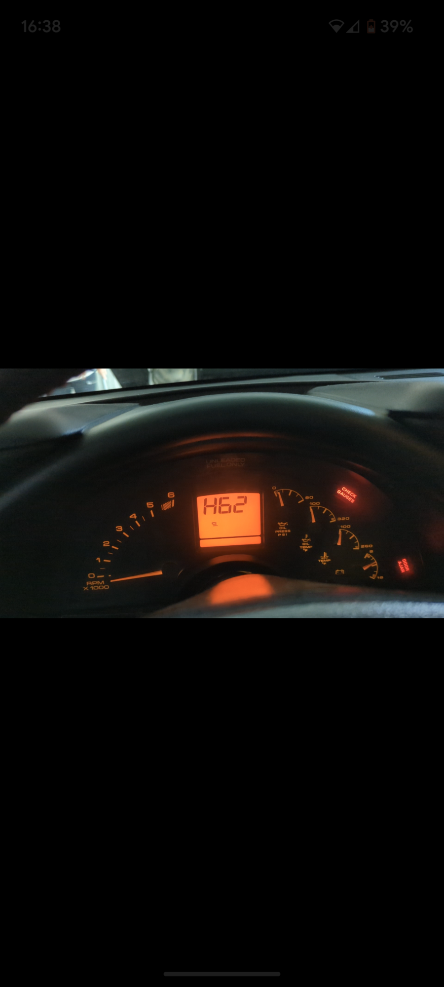

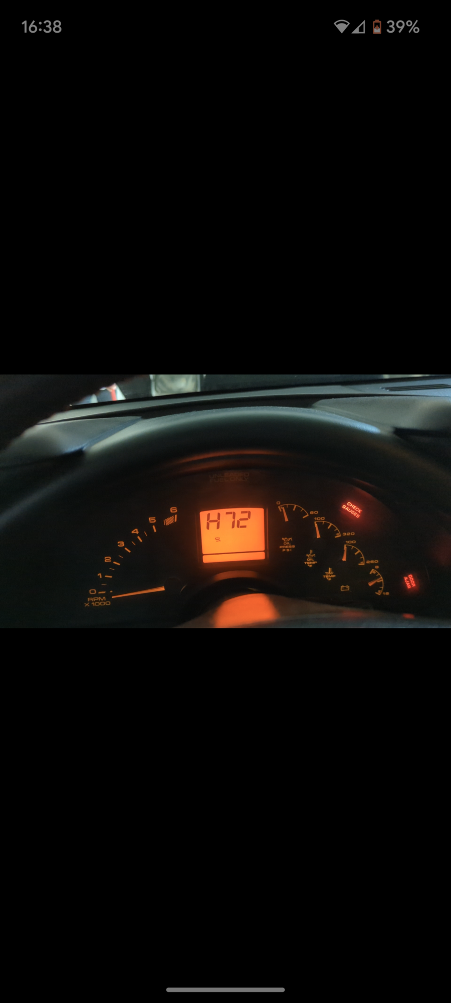

Old Aug 7, 2023 | 11:56 AM
Jo bar's Avatar
Jo bar
Joined: Nov 2021
Posts: 83
Old Aug 7, 2023 | 12:00 PM
Jo bar's Avatar
Jo bar
Joined: Nov 2021
Posts: 83
Optispark has 2000km, everything else 500km
Old Aug 7, 2023 | 12:21 PM
Jo bar's Avatar
Jo bar
Joined: Nov 2021
Posts: 83
Old Aug 7, 2023 | 12:51 PM
Jo bar's Avatar
Jo bar
Joined: Nov 2021
Posts: 83
Old Aug 7, 2023 | 01:24 PM
Jo bar's Avatar
Jo bar
Joined: Nov 2021
Posts: 83
Can you tell from these photos?thanks for your attention

Module 4 code indicates optispark issue. code 16 indicates loss of low resolution pulse from the OPTI (this is what is illuminating your SES light while running). Module 9 H62 indicates loss of tach signal (which would also be a symptom of loss of opti pulse since the opti goes to the ECM and the ECM uses that to generate the pulse that Module 9 piggybacks on for the tach). I got code H62 on module 9 among others due to an ICM issue, however the H16 would indicate that the issue is upstream with the opti itself and nothing to do with the ICM...
What brand opti did you use? Unfortunately a lot of them are junk and either don't work out of the box or fail quickly/with heat. It would also be worth inspecting/reseating the opti harness.
Do you have any "running" issues? Also note, I believe you have to clear the module 9 errors (once you've addressed your problem) via the dash (i.e. pulling the battery does not clear them)

Why was the original opti replaced? The pic of it sure looks like it was broken from the *outside* (ie someone prying against it say to remove the balancer. That doesn’t bode well for the shop that did this work…
