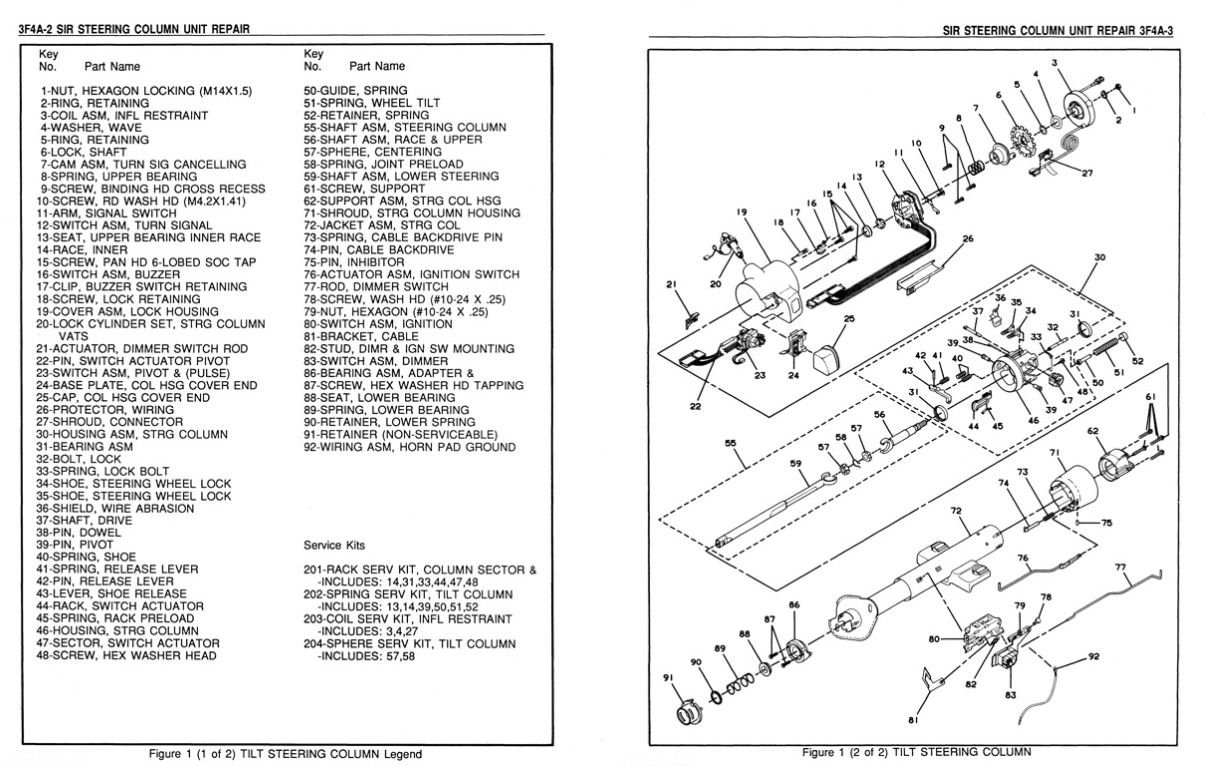

I see a '' Steering Wheel Lock Shoe'' mentioned twice.
34 & 35.

#32 Bolt & #33 the spring

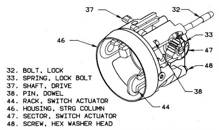

Looks like this is the best view of it in the FSM...

Page 34 & 35 in this 'typical' Saginaw tilt should help you. It's NOT a C4 column but typically the Saginaw Tilt is meant to be easily serviced. For the most part it is.
https://www.crankshaftcoalition.com/...ck_Rebuild.pdf

There's some good pictures in that file. Hopefully the springs on these aren't as complicated. I could fish with that thing.
Looks similar, though, comparing it to the rudimentary drawing in the FSM.
I get the gist of how it works, though. Thanks for that.
