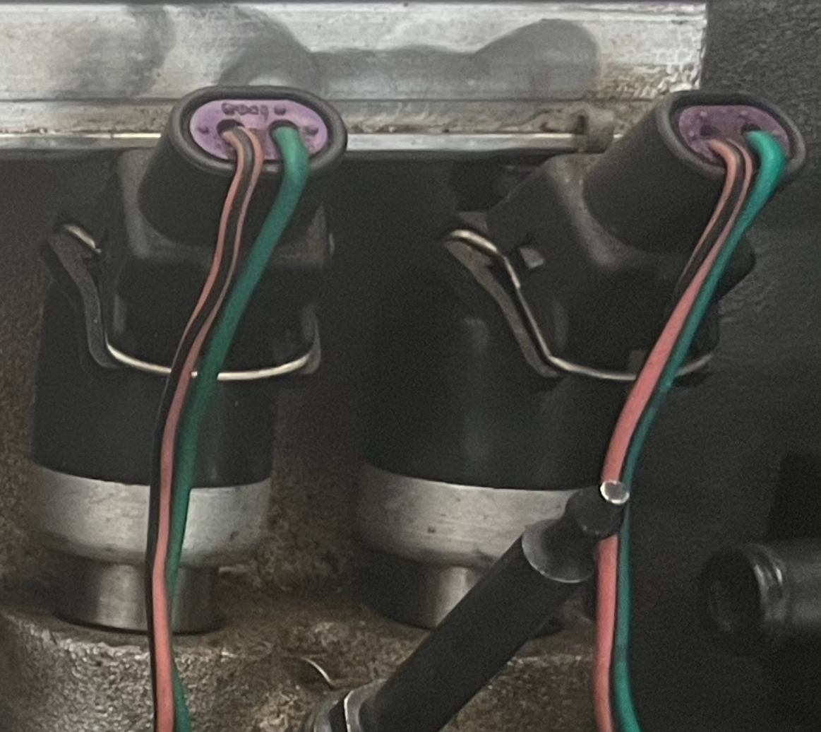

I have no idea of the brand or age. There does not seem to be any signage on them. Prev owner mentioned his mechanic had to install new O rings but did not mention injectors. Anybody know if these are OE or brand?
Originally Posted by 89onlyZ51
I'd say it depends on the injectors. If you have multechs with shorting coils (low ohm reading), replace them all as others won't be far behind. If you have bosch and have damaged injectors, you can get away with replacing the faulty ones in a pinch. Regardless, definitely do all orings, fuel rail, and fpr diaphragm because they are old and will leak when disturbed. Personally, though, I replace them all unless funds are real tight.

Those look like multechs - replace them all.
