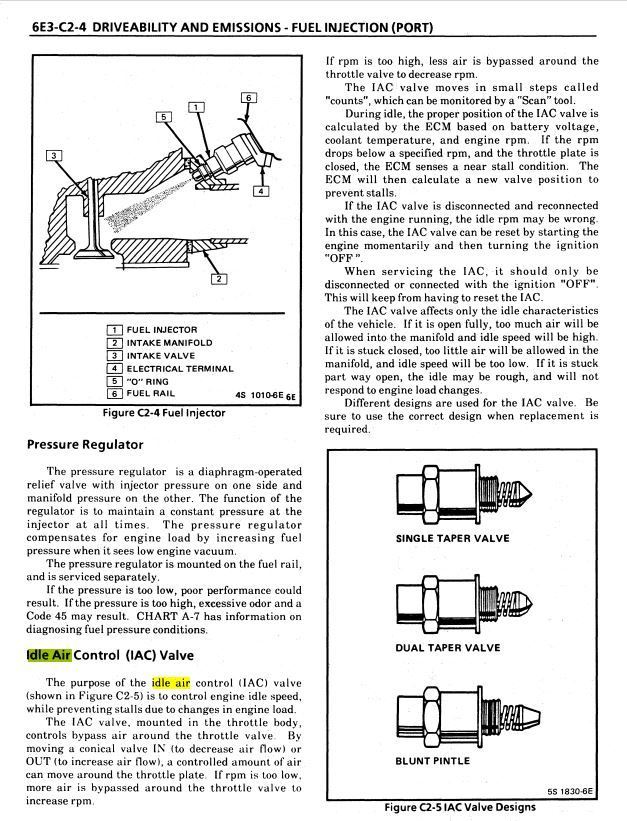

You said you changed the IACV. Did you get the right IACV pintle head. There a few different types and you must match it to the original one (see below). Also there should have been instructions with the IACV on how to adjust the length before installing. Did you check the length of IACV extension before installing?
We really need to solve the Code 44 before proceeding. Did you follow the Code 44 instructions from the FSM I posted earlier?
