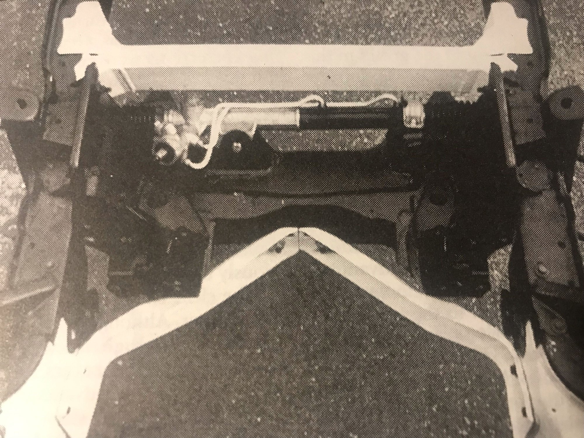

I have an 85 Z-51 car, and I have never noticed any weirdness coming from my frame, top on or top off. On the Z-51 cars, there are extra frame braces that have been attached, and I'm thinking that this makes the difference, just as much as an X brace would do. If you can't find the X, then this may be the way to go.
Old Oct 5, 2023 | 01:26 AM
AZSP33D's Avatar
AZSP33D
Joined: Jun 2020
Posts: 1,716
Likes: 745
From: Stay dangerous my friends
That's for the 1987+ Z51 cars, and 1986+ Convertibles... and this (the scallops at the bottom) are required in order to fit the X Brace.
