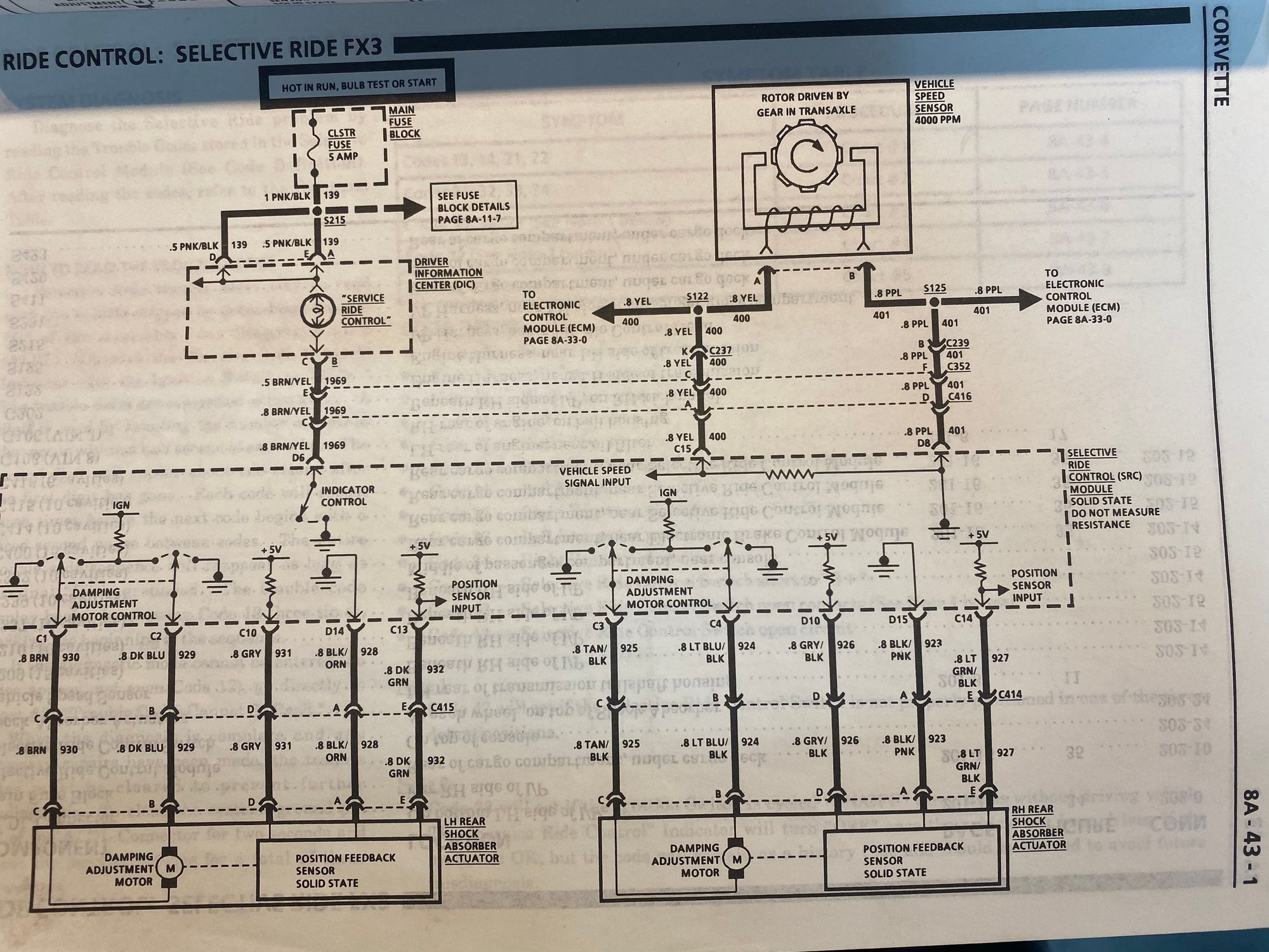

Does removing the ride control computer impact the VSS signal at all? I read that VSS is passed first to fx3 then off to ecm?
Don’t believe everything your read. Especially from people who don’t know what they are talking about.
Wires come off the VSS and then there is a splice 122 and 125 where the signal is sent to the ride control module.
Fantastic... Thank you.
So just remove the shocks, actuators, and computer and no dash lights to deal with then?
