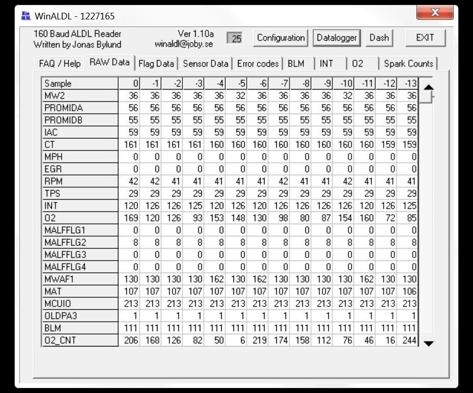

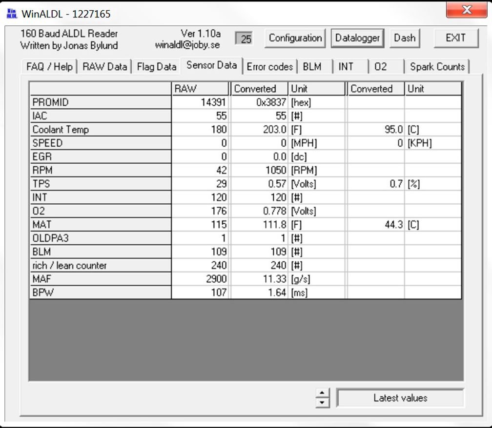

Drive it & Vets Vet: I already have a Zurich ZR13 ODB2 reader from Harbor Freight that I use on my newer vehicles. It doesn't plug into the ODB1 diagnostic port on my 1986 Corvette. The ZR13 reader will display live data if its available. I can purchase a ODB2 to ODB1 cable converter for GM vehicles from Amazon. I'm considering purchasing it for $9 and giving it a try. The ODB1 connectors provide limited data from what I understand, since computer technology was in its infancy at that time. It sounds like you have experience with this and it should give me some type of live data, right? I read the reviews on the ODB2 to ODB1 cable converter at amazon and many of them said they couldn't get live data. Here's a link to the converter cable:
Amazon.com: OBD2 to OBD1 GM Adapter,OBD1 12 Pins to OBD2 16 Pins Diagnostic Tool Connector Adapter Cable Replacement for GM : Automotive Amazon.com: OBD2 to OBD1 GM Adapter,OBD1 12 Pins to OBD2 16 Pins Diagnostic Tool Connector Adapter Cable Replacement for GM : Automotive

I can't say on the adapter cable working as I've never used one. I've always used an OBD1 scan tool or Diacom on an old laptop. You do get plenty of live data to figure out problems-though the newer OBD2 does give more.

Don't waste your time or money on the Zurich. I am not the one to guide you into OBD1 land but you need to understand you need a dedicated OBD1 data scanner. There are a lot of adapters, and code readers and crap out there that make you think they will and none will help except an OBD1 data scanner. there are $9 and $30 code readers, they are nothing more than paperclips to short 2 pins together so you can watch the car blink numbers at you and tell what number code you have. The previous post I gave has 2 of the very few methods unless you have a pretty expensive and or old dedicated OBD1 scanner or some $2400 snapon scanner. You are in for a learning curve so don't start out spending 2 weeks learning the hard way like I did.
