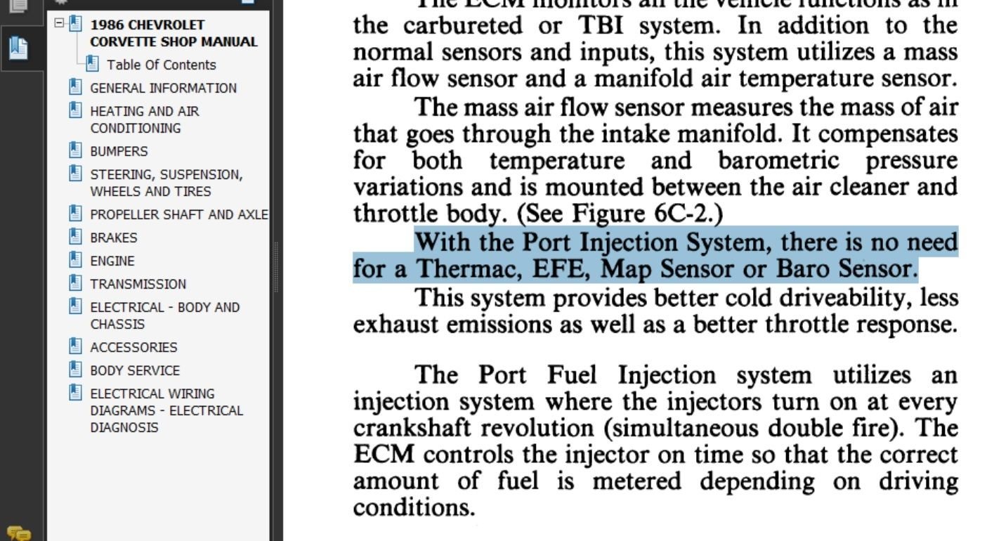

There is no MAP sensor in the 86 corvette. Manuals are sometimes for multiple models of vehicles.

Thank you Vets-Vet. That puts my mind at rest. I was going nuts looking for the MAP sensor. I was getting the feeling that a MAP sensor isn't used with a MAF sensor, but I had nothing definite. From your picture, it looks like you have a great resource for older Corvettes. Is it available to the public Internet or is this something you must have a subscription for?

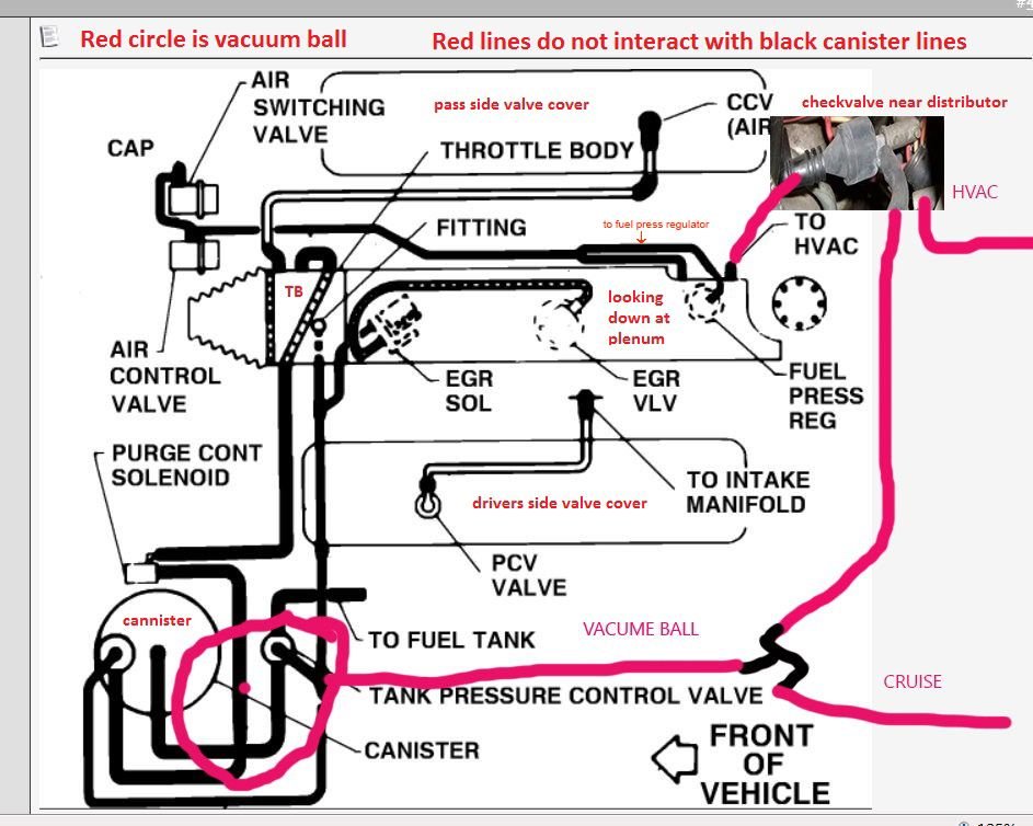

Yes, it is a PDF of the Field Service Manual and it is invaluable as is the ability to see info from the ALCL. Did you see TommyFox's suggestion of O2 ? Check the air bellows between the MAF and throttle body and make sure it is air tight and not folded under on the ends. The MAF reports an accurate count of air passing through it and that bellows should not be allowed to let any extra in. Tune up ? Air filter clogged ? Vac hoses OK ?

Thanks Vets-Vet. That description of the MAF boot made it much clearer to me. Thank you for the vacuum diagram. It looks like I need to check the red vacuum lines in the diagram, right? What's the vacuum ball that you're describing? What are the black lines for? You seem like you're a sharp mechanic and I appreciate your help. I've always done some of the work on my own vehicles, but diagnosis can sometimes be tricky as you know.
