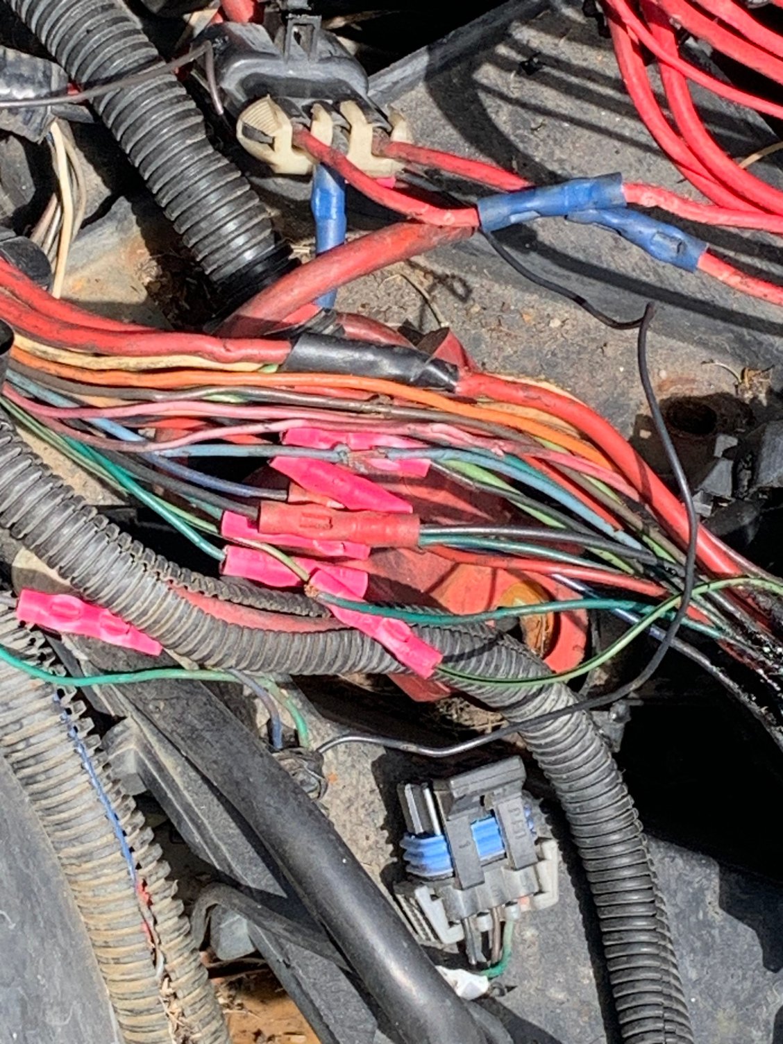

Originally Posted by Phobos84
Ok...wait...backup. The engine wiring harness was destroyed by dogs? I would love to see a picture of that.
Yep, they chased squirrels into the battery compartment. Not to mention the fender.
The harness was completely chewed through here and others tried to fix it unsuccessfully. There’s more places where the wires were cut and people used them to try and start the car which just made it worse. Can’t find them cause everything is a mess right now.

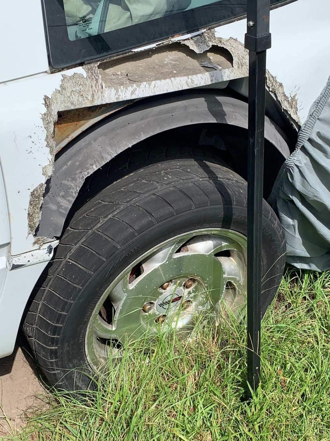

Dogs ate this fender alive. Fiberglass can’t feel good coming back out
