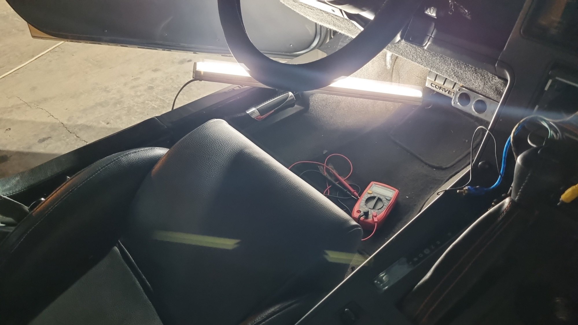

2 problems on my 1984 c4.
1. The driver seat doesnt go backward.
it Seems like defective switch, it doesnt make any sound, all the other controls work.
Is there a way to move the seat back until i work it out?
Thought about triggering 12v from the connector directly to the motor, but i dont have the wiring diagram so i can just try and see which one of the pins is the right one. Unless someone have a diagram.
2. The brake warning light comes on ehenever im in hard cornering, i thought its the fluid level but both reservoir are full. Any other things to check for?
thank you, from israel.

Originally Posted by IHBD
This is from a 1985 manual, the 84 may be the same:
Forward - Back motor wires are red/grn and yel/orn The forward - back motor is the one in the middle, IIRC the wires go into each motor individually, so you can verify the colors.
Yel/orn to (+) Red/grn to (-) is BACK.
Red/grn to (+) Yel/orn to (-) is FORWARD
For the BRAKE light, if the brakes are normal, I'd look at the park brake handle and assembly. Perhaps you're shifting your leg or weight into it during "hard cornering" and activating a touchy switch adjustment? Only a thought.
thank you i would try.
about the brake - i tried to hold the lever and it doesne change much. It even happened when i drove uphill, i asked a friend from our local c4 group, he said that there is a spring that close contact ans usually it rusting and i just need to take it out and clean it.

Old Oct 28, 2023 | 06:36 PM
EliC25's Avatar
EliC25
Joined: Aug 2023
Posts: 16
So in my wiring its the red/green and yellow/green. I just reversed them from the connector and press forward - and it went back
Thanks for the help

Originally Posted by ref772
This video will show you whats going on in your seat transmission.
https://youtu.be/7lJH6Nx-GxI
thank you
The motors are fine
Its the switch
