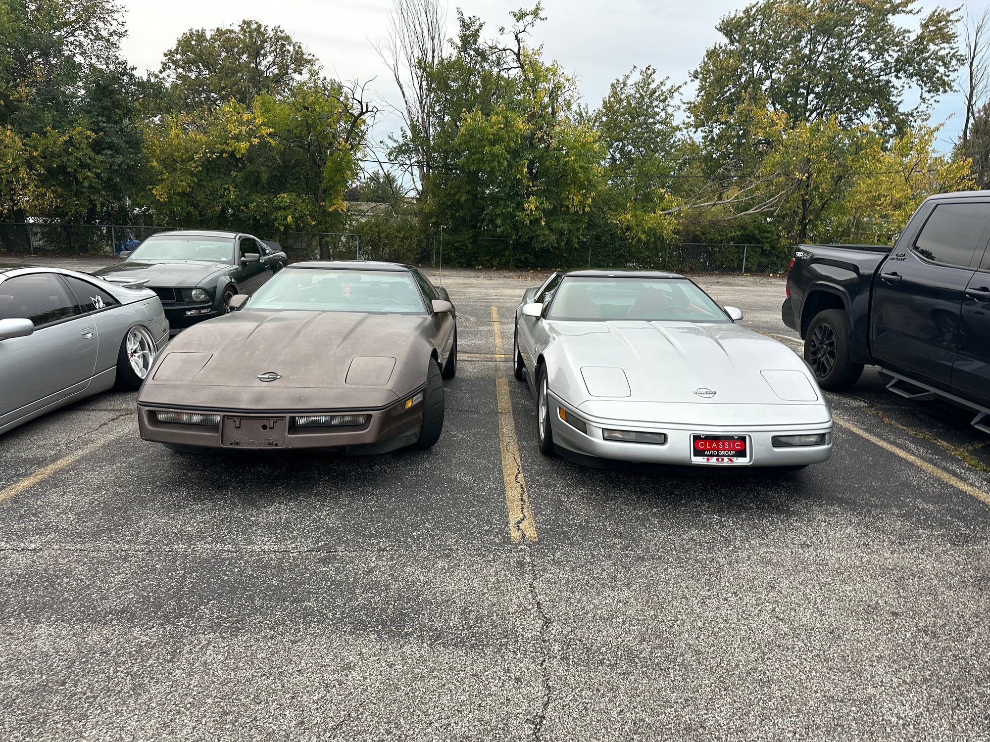

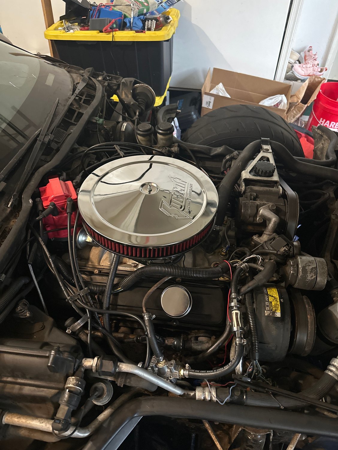

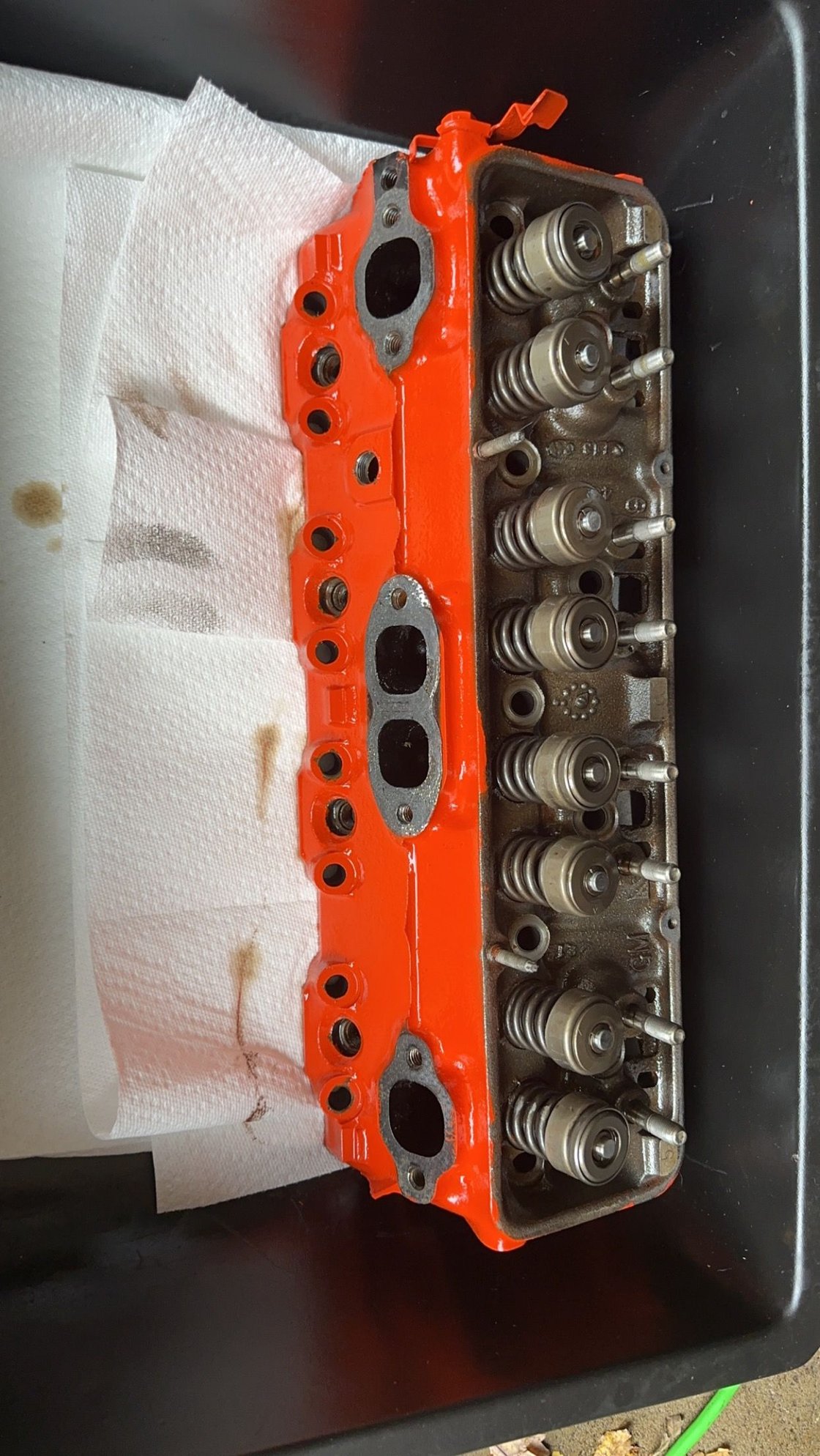

Currently after getting these head gaskets straightened out (whole reason i even considered a cam was because half the top end was torn down already) is a set of hedman long tube headers, currently have 3in SS midpipe back that its gonna be connected to, no cats. After that im probably gonna focus on rebuilding the entire suspension system, which than would probably involve the gearing but theres no point in adding power if you cant put it down 🙃 heres some pics for anyone interested, its a very rough project indeed
After i got it running for the first time since '98
Gutted a bit
painted the heads
c4 buddy, mine on the left
