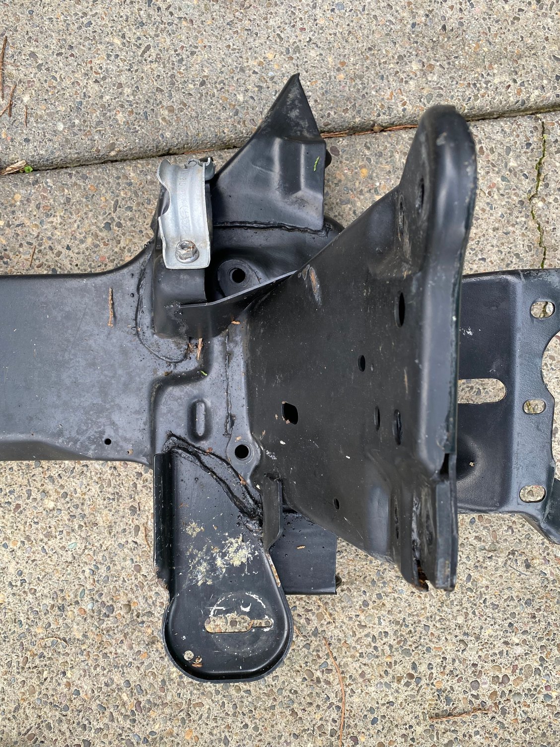

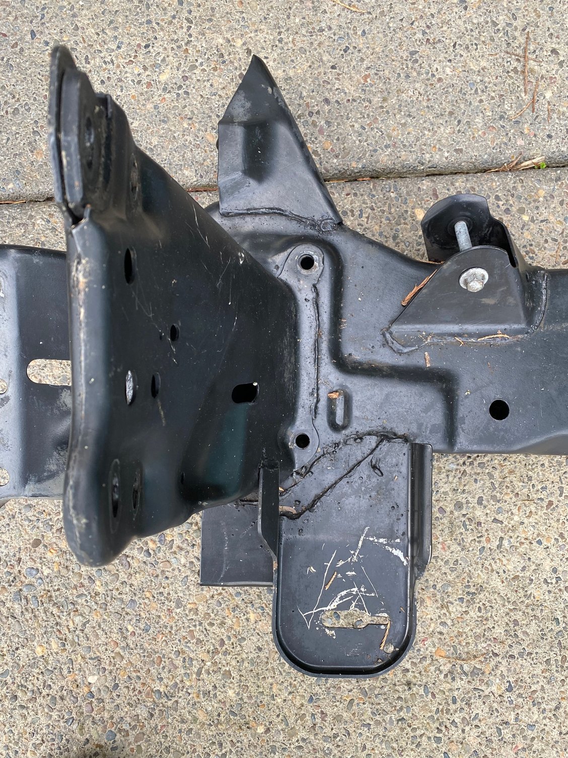

Originally Posted by SynthwaveVette
Thank you! Just wondering if you know where exactly the bolt head on the top is, and if I can get to it from up top. Also how much would it be for just one mount and a pair of the nuts and bolts?
Here is a cradle from a 92-96, engine mounts are different, but the hole locations are the same. I’ll do 20 shipped for the mounts and bolts.
