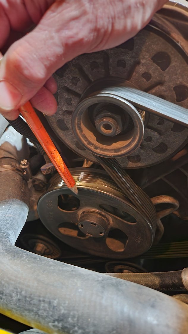

Pump is still leaking so next week I am going to replace it. I'll use Gibbs fluid and want to replace the pressure line with a DRM stainless line as recommended above. But, I cannot find DRM online as a parts supplier. What should I be looking for?
Please see the photo below. That's the pump I'm pointing to with the pencil, correct? Doesn't look like that tough a job after all, especially if I move the alternator and maybe the AC. I know I'll need to borrow a pulley remover. Any other tips on wrench sizes, crow's feet, etc.? Do I remove the pulley in the car, or after it is on the bench?

The pump isn’t a hard job. That is it which you point to. And for 800+ you are far better off doing this job yourself and saving a ton. I believe the DRM line runs THROUGH the serpentine belt. So in other words to change the belt you have to pull that line. It’s a big trade off you have to consider. Someone correct me if I’m wrong but this is what I recall from looking at this a few years back. I went to replace my high pressure hose a few years ago with an aftermarket one and it refused to align/fit. The 30 year old hose went back in and still works to this day without issue.
