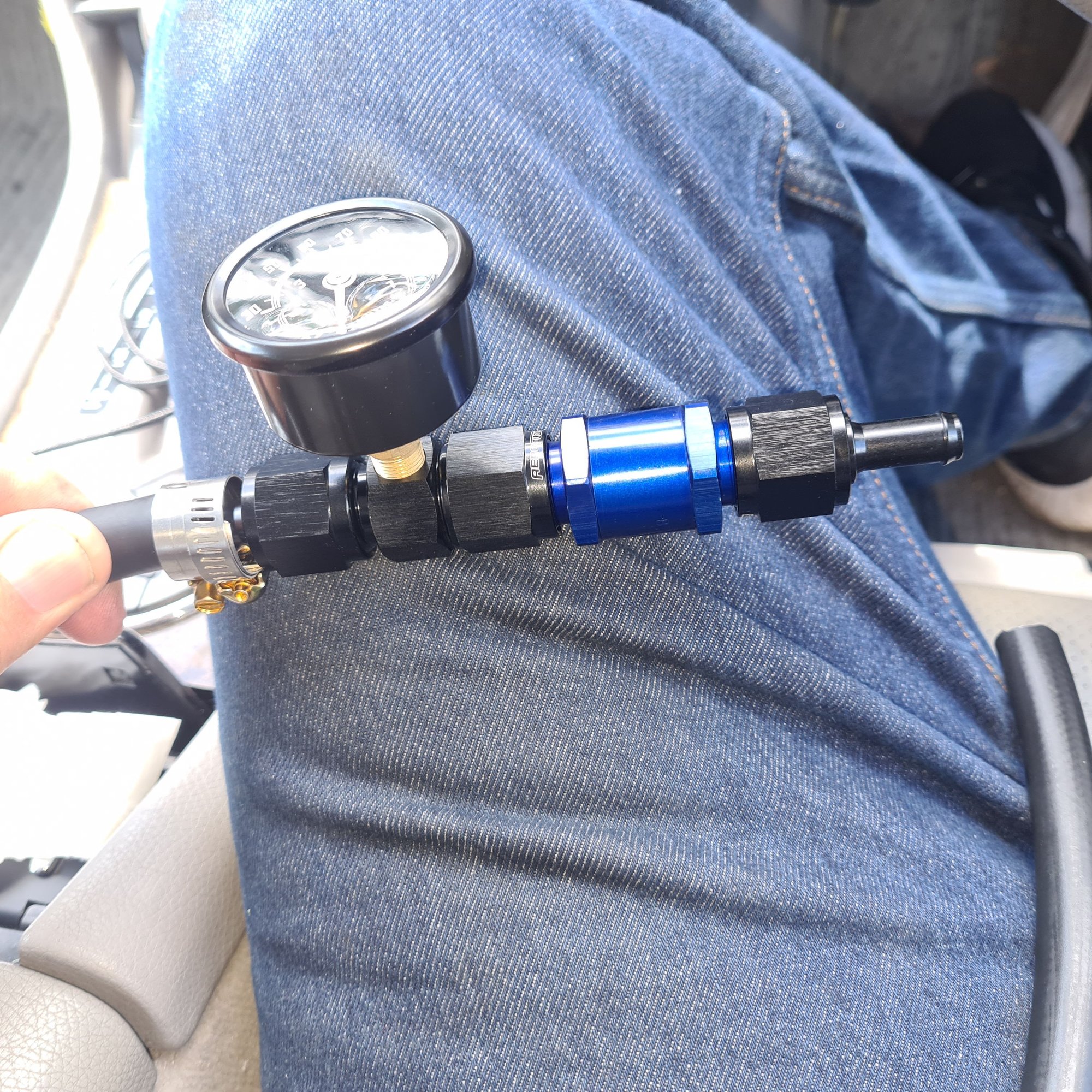

So, I went down to the local speed shop and got them to collect me up parts for an in hose check valve, and pressure gauge.
Mounting the fuel pressure gauge on the engine side of the check valve allows it to read the pressure in the system right through to the fuel rails.
I celebrated this with a quick stop at a brand new store here......it's called Taco Bell.......not particularly great, but did what it was supposed to do.....
10 minutes of installation later;

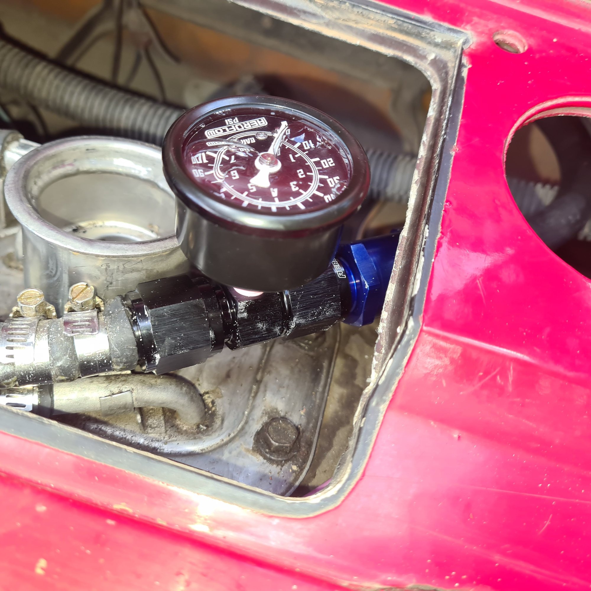

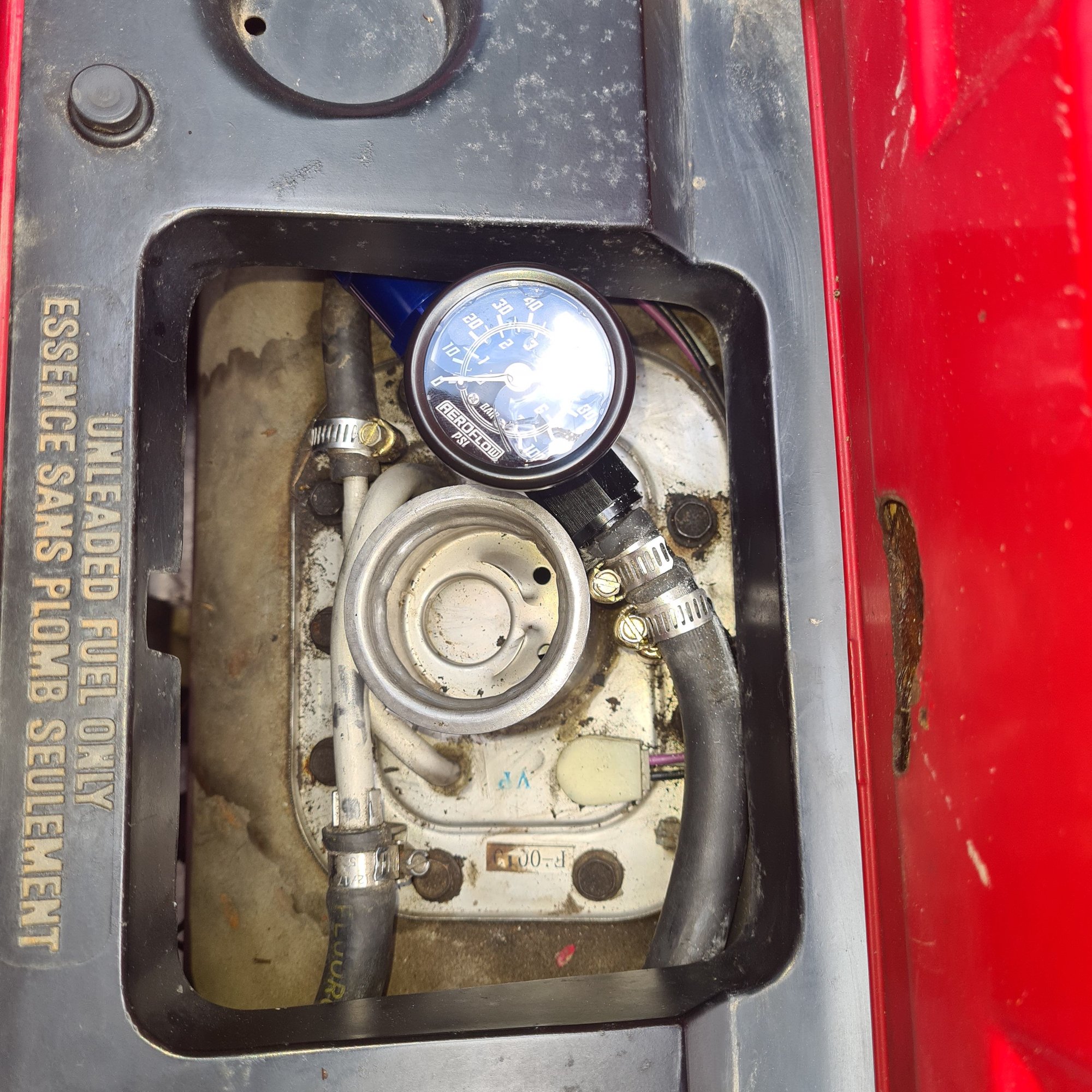

And then I fired the pump to prime.
Pressure went straight to 55 psi.
Turned the key off.
.......drum roll please.......
Pressure did not budge!!!!!
Did I dare to try to start it without any ether???
It started straight up.
Turned it off again.
Pressure didn't budge.
Started straight up again.
I cried just a little.........
I left it turned off for as long as I could handle.......approx 60 seconds.....
Pressure hadn't moved.
Started straight up.......like a normal car........no tap dancing or indigenous tribal throat singing required.....

Remember that there is a pulse damper between the pump outlet and the hanger that could be your source of bleed down. For testing, you can replace it with an equivalent piece of appropriate fuel line (that will survive inside the environment of the tank). Many just delete the damper.

OK.
The morning after......
System still loses all pressure in less than an hour, so something is not as designed.....but.......pressure IS held after initial prime, so car starts......
I'll take that as a major WIN!

leaking down in an hour is fine. “ no worries “about that. you may have a leaky injector but thats a very slow leak. ive never had a c4 that didnt leak down. your case was extreme and its the second one ive seen on the forum like that.
As mentiomed you may have a split or torn or split component of plumbing at the pickup. I dont think it would be too tough to order a replacement kit even if u are in the outback. 👍
