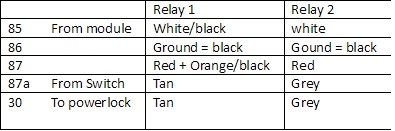

I found the aftermarket console in my driver side door. It was full of water and didn’t work, so I ordered a new similar one. I can’t get it running because I am a total powernoob.
The power lock switch is working, and it has two relays.
FOAB 14B192-AA
The 86 and 86 are bridged.
The old module one was wired like this:
· Red + yellow/black + yellow together on red.
· Black + orange/black + orange together on black
· White/black on relay 85
· White on other relay 85

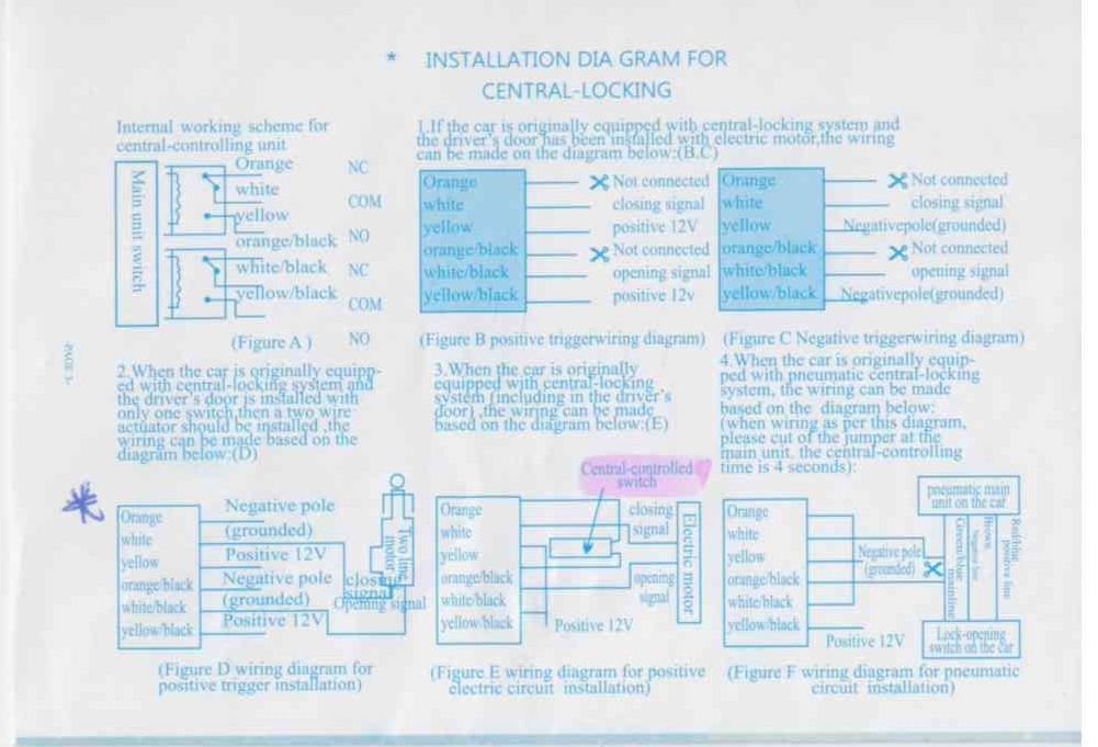

The new one came with this instruction. I used figure D because that seems the same like the old one was wired.

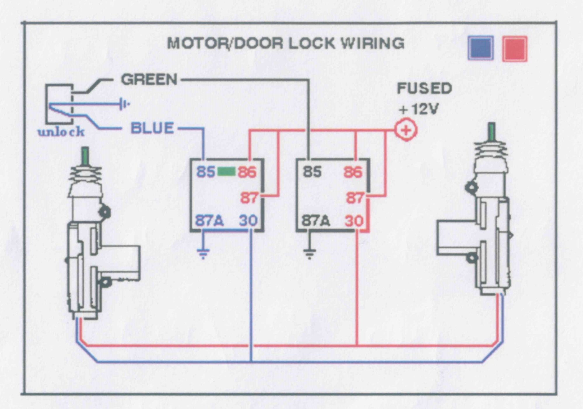

I think I installed it exactly the way it was … and it seems good but doesn’t work. I found another schedule of relays in a power lock and they are wired totally different.
· Am I using the wrong schedule ?
· Are the relay broken ?
· Are the relay wrong connected ?
