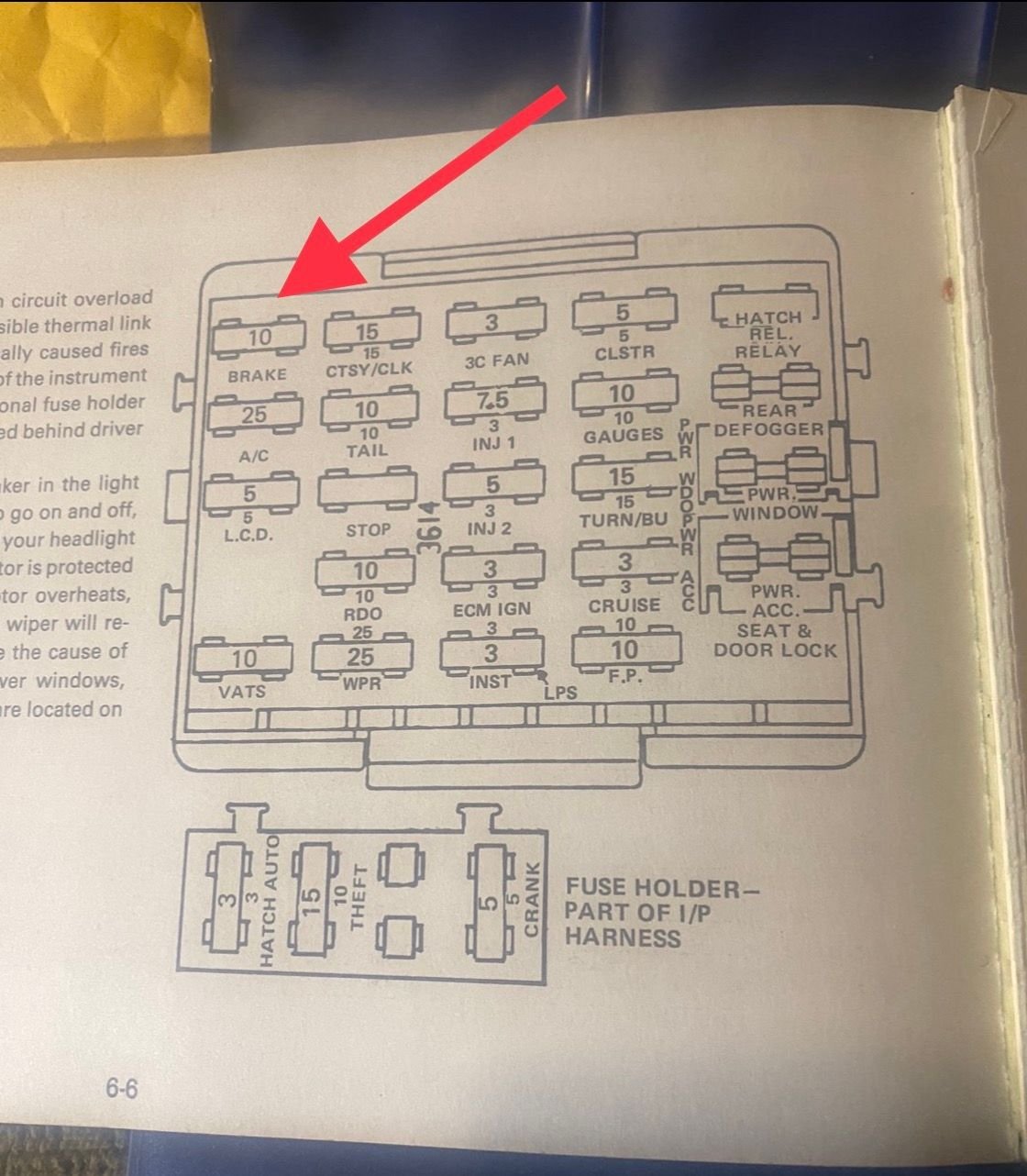

Your ABS pump is located behind the drivers seat. If you have a coupe it is under the storage door and if you have a convertible its below that speaker. There are 3 relays you can check , one for the module and two are mounted on the ABS pump itself.
First check the fuse.

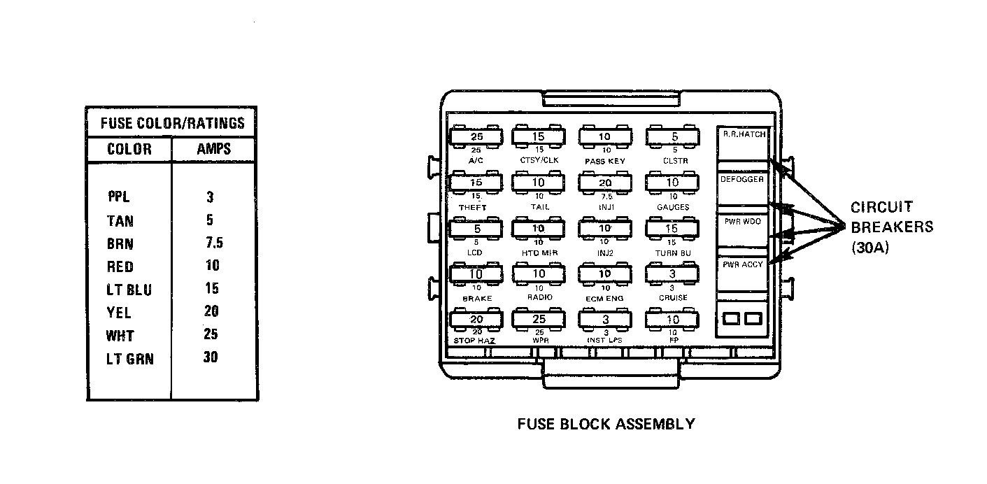

Poster #2 that doesn't look to be an '89 Fuse Block. Where is that image from? Maybe an '86 Owners Manual?
This I believe correct for an '89.
Yes mine is a copy from my 1986, If the fuse panel changed in 1989, I was not aware of that, I kind of guessed the panel would have changed in 1990 when they changed the interior though. sorry for the confusion.
