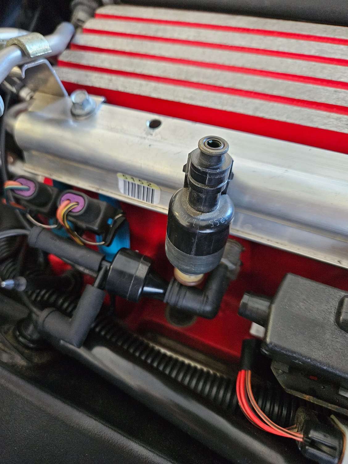

Originally Posted by biker mike
do you know exactly where it is i looked and can't find it
It is under the cover between the manifold and valve cover. It's a black cylindrical valve with one tube on one end and 2 on the other. See attached pic.
After checking that, check the vacuum lines (all of them) to ensure they are not kinked or cracked. The lines at the cruise control servo will literally rot to dust.
If all that checks out, then your issue is most likely the controller under the dash, driver side. I bet money that's it and it is an absolute exercise in patience and dexterity.
