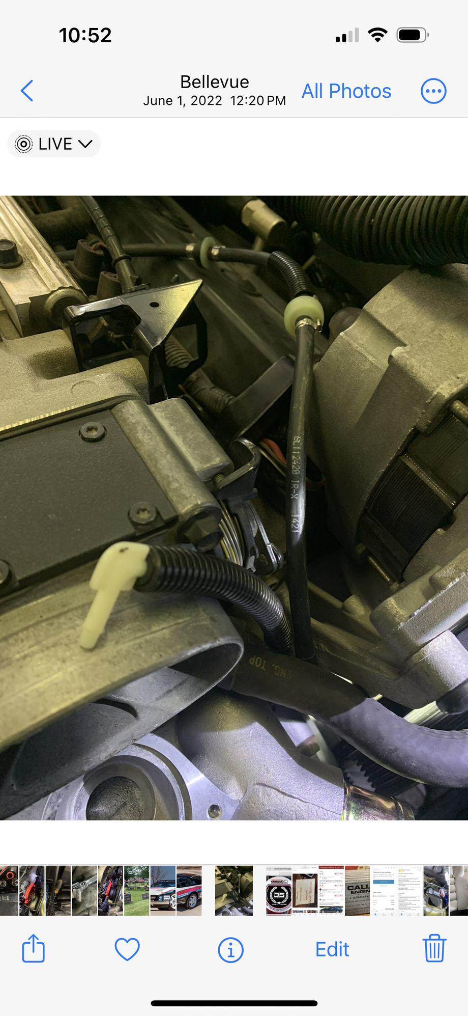

I installed a vented opti kit from Petris on my 93 Vert. I ran it like it was done on my 96.I’ll attach a picture. The vacuum lines run in between the water pump and the power steering pump. They run next to the water pump and not in front of it.

Cool. Thanks for the pic. And your time. It's too late now, but I can finish putting it together tomorrow after work. Then I can put my doors back together Saturday morning and start driving.
