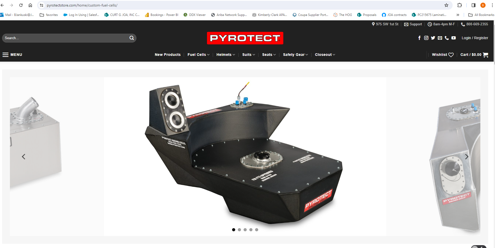

Pyrotect modified my stock tank to be E85 compatable with baffles and road race legal.
Not cheap by very well done, the picture is just one from their web site.
