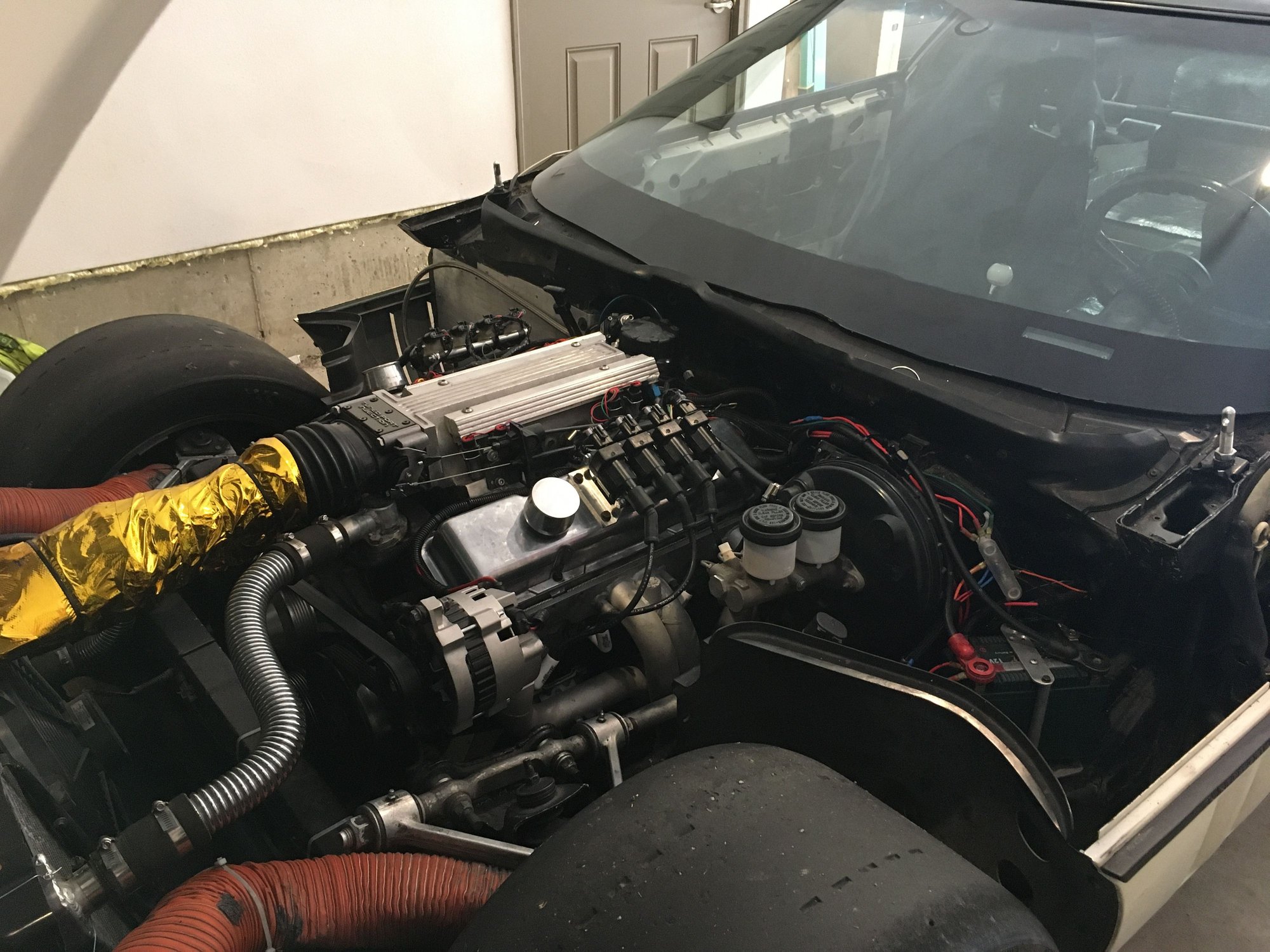

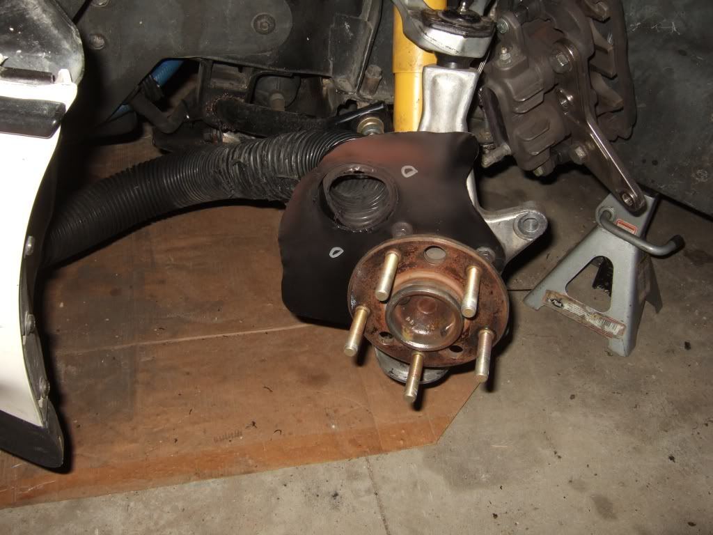

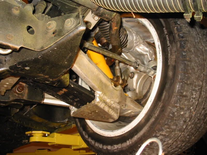

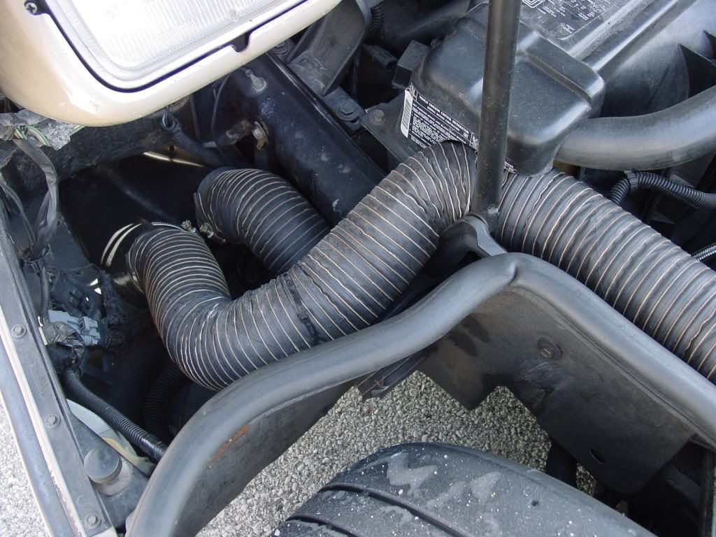

So just curious, i know the obvious benefits of brake cooling. What im curious about is how the duct work is ran to the brakes? Seems like no room in there. Thanks!

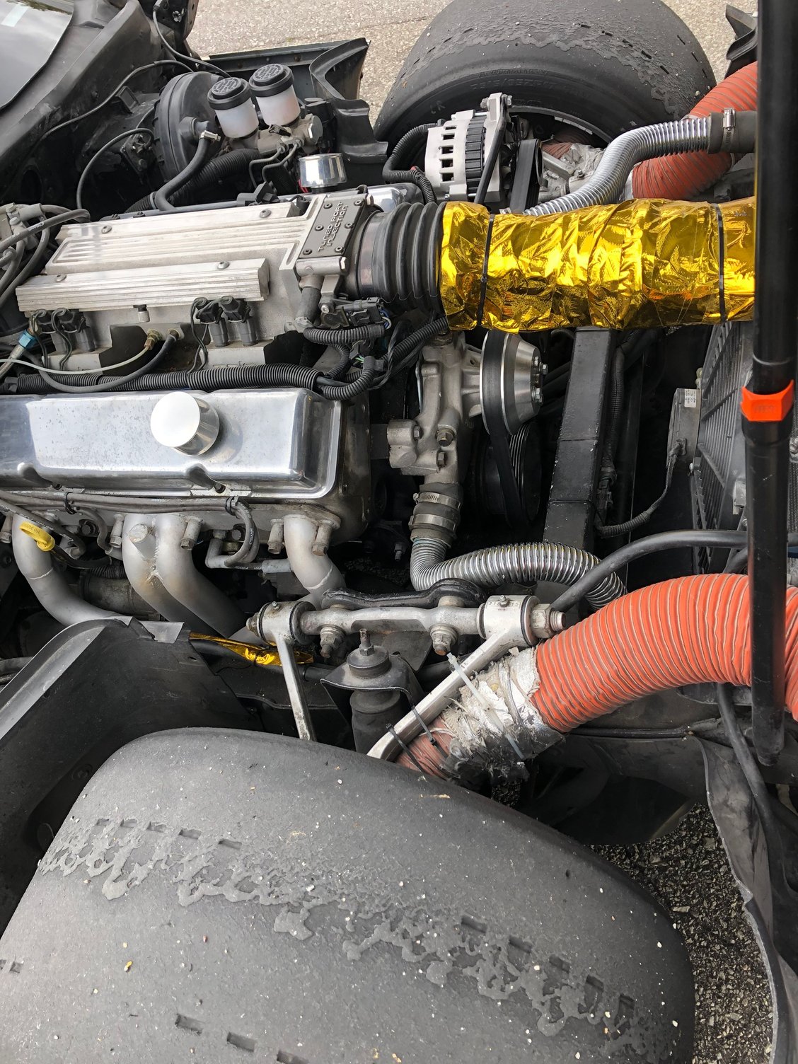

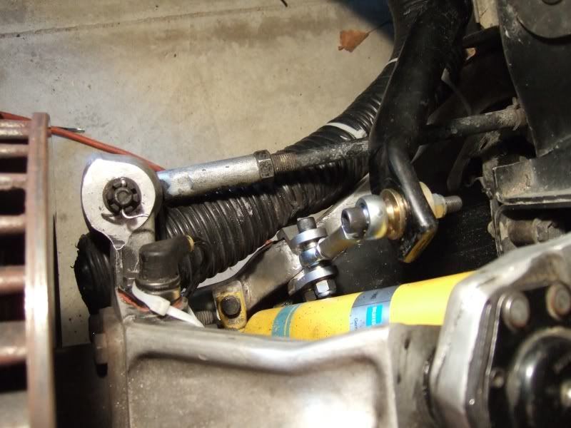

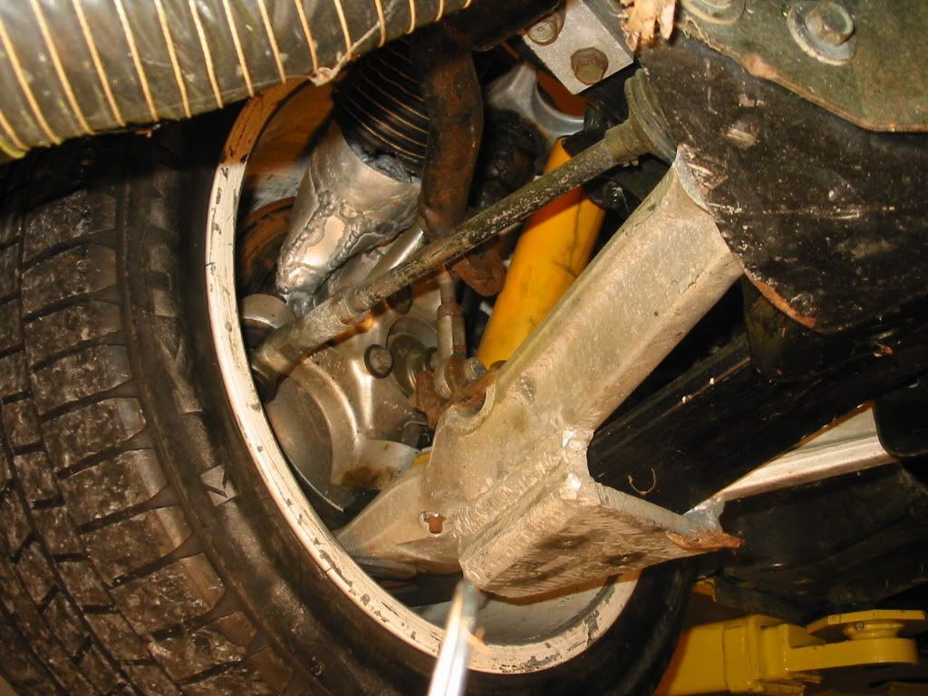

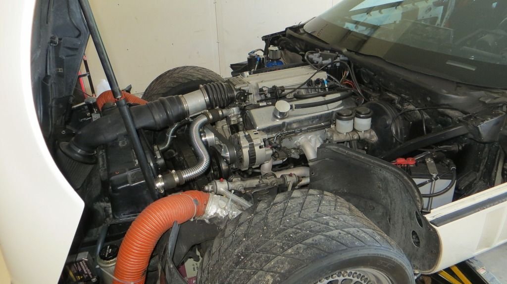

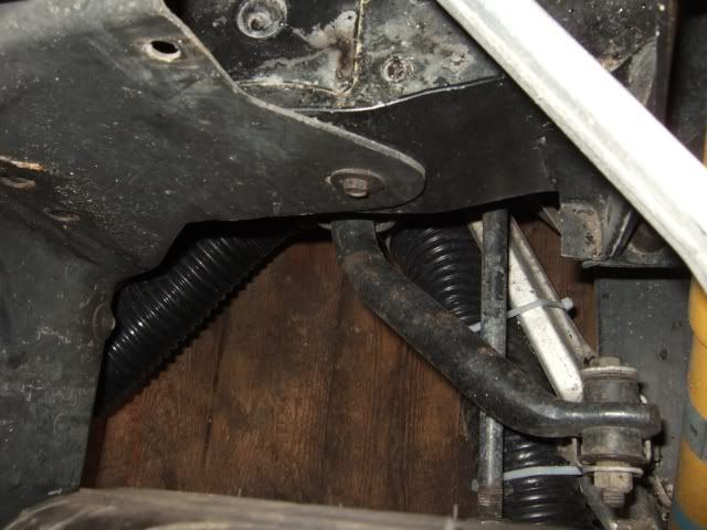

There are a few ways it can work. I usually go through the top A arm which leads to the tube getting a bit oval. There is a longer path to go back around behind but that uses a lot more silicone tube.
Any pics?

Sure I'll attach some pix

Hey thanks, i appreciate it! Again was just curious how its done.

No prob! The 3" duct would get a little more beat up but could just be fixed with RTV. 2" was easier to get to last without glue!
