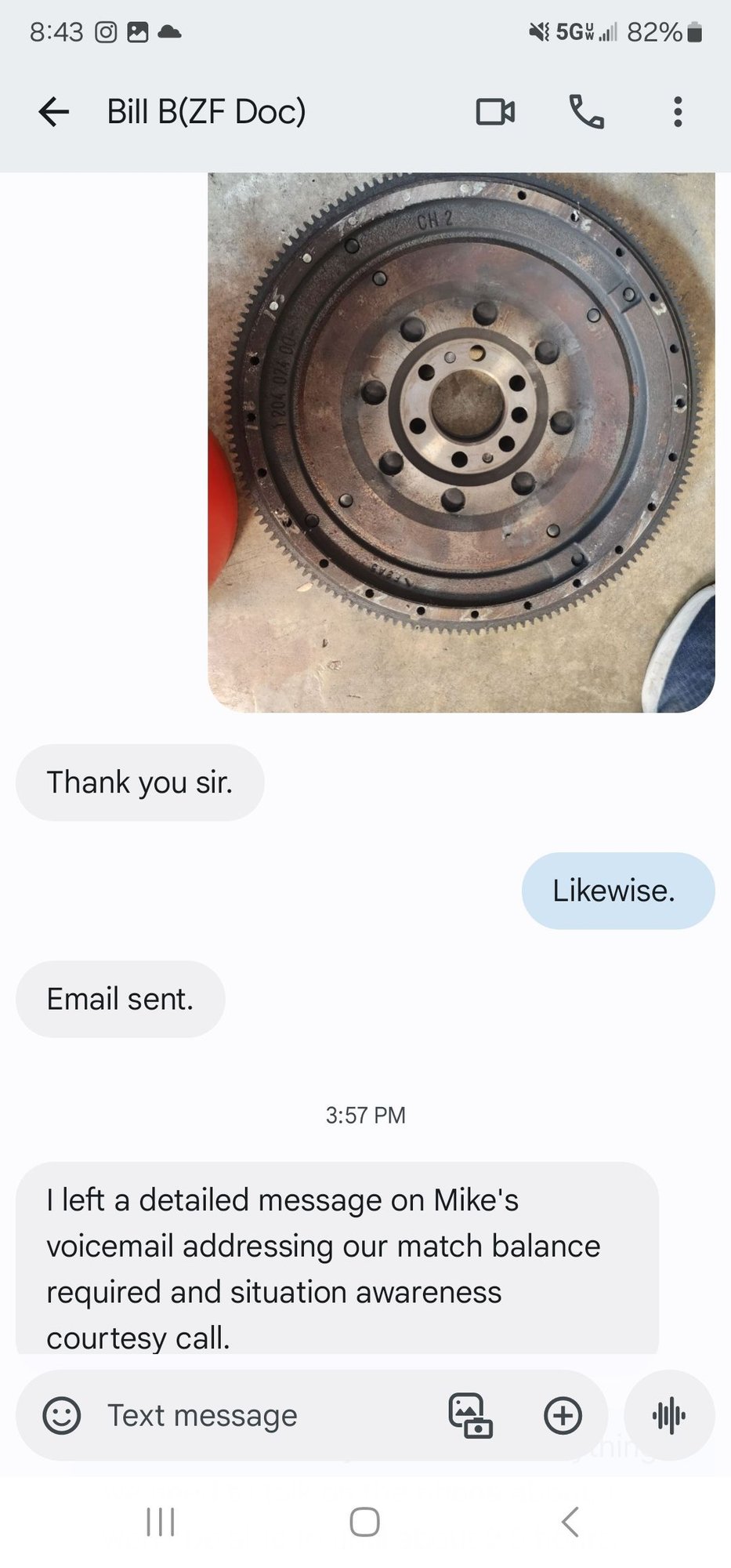

My car is a 96 lt4 as well. Bill is adamant it needs to be balanced. Mike(see screenshot of the email he sent me) is adamant it doesn't need to be balanced. Lol I have no idea what to do.

Just spoke to Bill and RAM. RAM says yes, they might have balanced my flywheel incorrectly. So, I'll be shipping my oem flywheel to Bill. And we'll go from there.

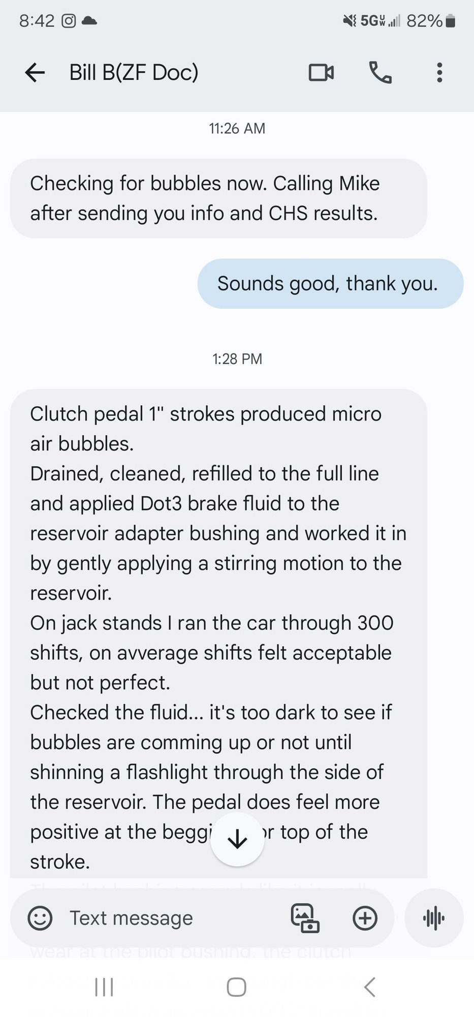

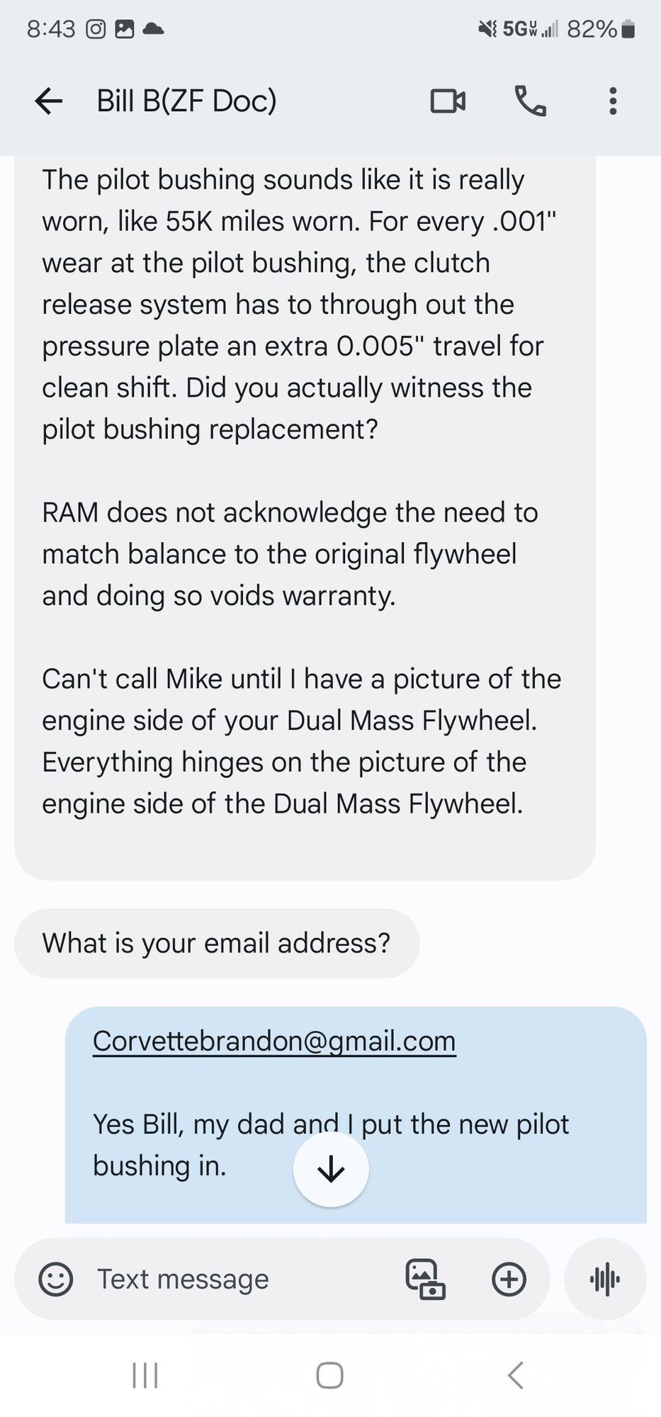

The latest from Bill.

I don't remember leaving anything untorqued. But whatever. I just want my car correct.
