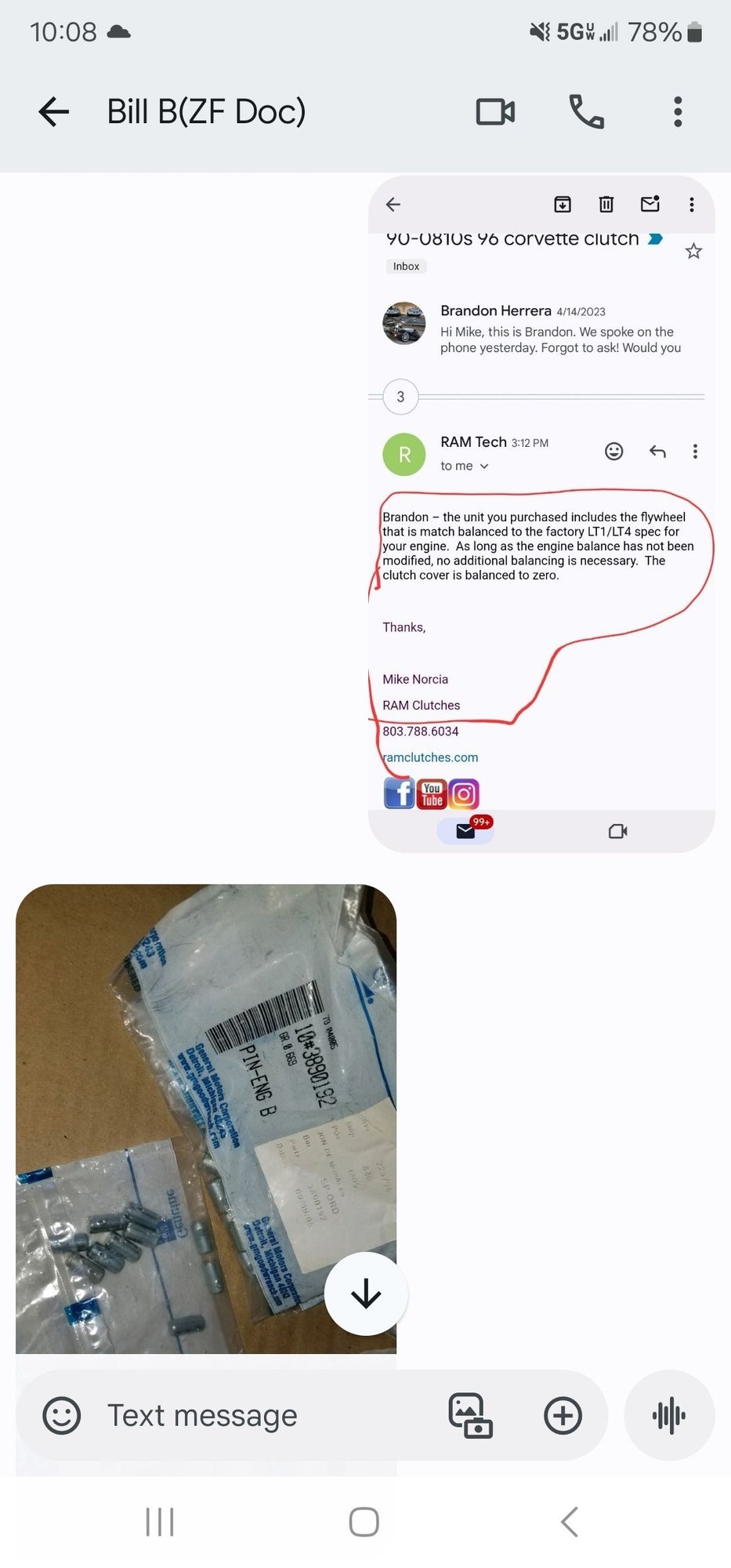

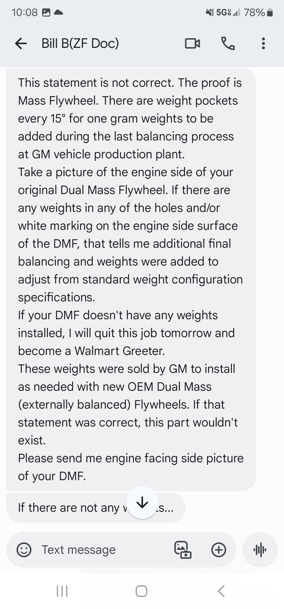

My car has vibrations at 3k rpm and above.
Never had this prior to the trans removal.
Even has the vibration when you rev it, at idle.
Bill B(ZF Doc) believes it is the flywheel balance. But, RAM flywheels do not require balancing. So, he is going to talk to Mike, owner of RAM clutches, tomorrow.
Either way, this is an interesting situation to be in. See my screenshots.

so did bill have to become a walmart greater or did ur dmf have weights on engine side?

I will look at my oem flywheel shortly, and post pics of it. He also says the vibration is due to an ignition problem. I have never touched the plugs or wires since I have owned this car. I can for certain, car doesn't misfire and pulls effing awesome-smooth with no pauses to redline.
