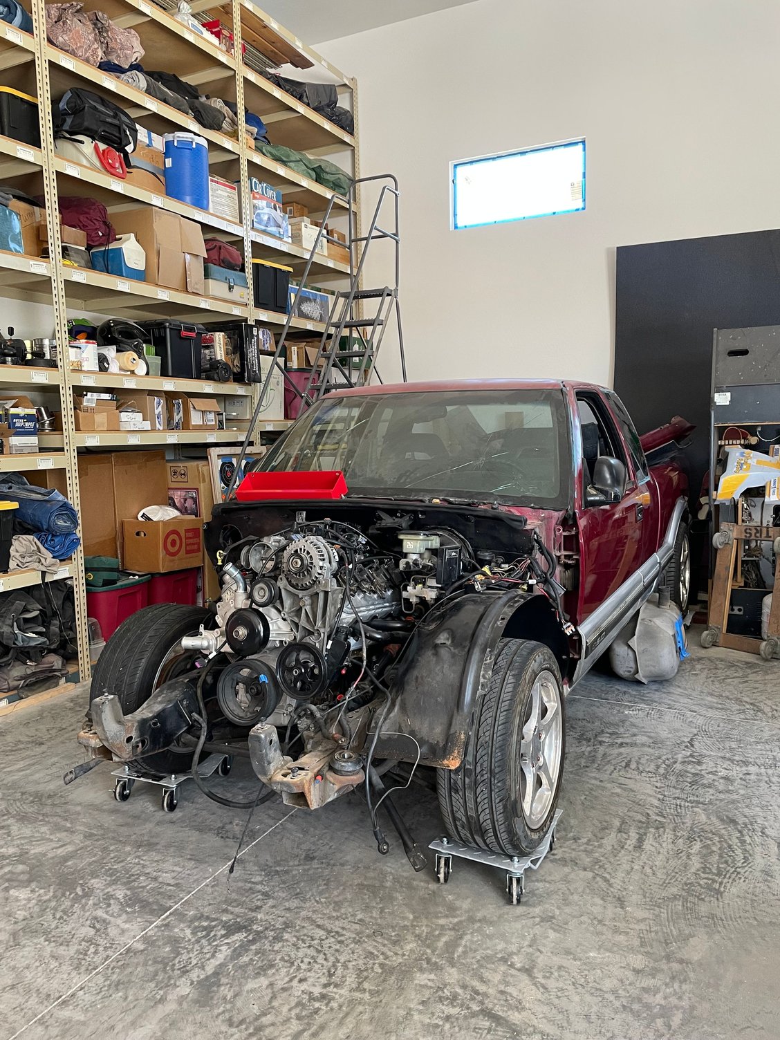

Hello!
Super new to the forum, and looking for some help/advice.
I've been working on swapping a truck 5.3 that I built out to a 5.5 with redone top and bottom end paired with a Tremec T56 Magnum into my 2nd gen S10.
I've decided to take the project a different direction and move to the C4 platform (wanted to change what the goal of the setup was), which I've always been a fan of. I've spent the past week or so looking through various forums and websites to try and compile information.
Are there any common issues that people run into when doing these swaps? Is there anything that I should be aware of as far electronics go? Common overlooked parts with a swap like this?
I know that I'll need to get headers and swap out the accessories on it. Is there anything I need to know as far as maintaining A/C and heat, as well as clearance issues that people run into?
Any help would be fantastic! (Attached is a picture of my s10 as it sits right now).
